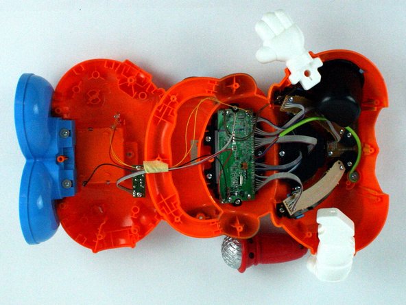

Having issues turning on and off the Vtech Learning Tunes Karaoke? Follow this guide to solve the problem.
    1. VTech Learning Tunes Karaoke Power Button Replacement, Power Button: crwdns2935265:01crwdnd2935265:01crwdnd2935265:01crwdne2935265:0
      • To remove the battery door, loosen the 4mm screw using a Flathead screwdriver.
      • A coin can also be used to loosen the screw
    2. VTech Learning Tunes Karaoke Power Button Replacement: crwdns2935265:02crwdnd2935265:01crwdnd2935265:02crwdne2935265:0 VTech Learning Tunes Karaoke Power Button Replacement: crwdns2935265:02crwdnd2935265:02crwdnd2935265:02crwdne2935265:0
      • Remove the battery door and take out the batteries.
    3. VTech Learning Tunes Karaoke Power Button Replacement: crwdns2935265:03crwdnd2935265:01crwdnd2935265:01crwdne2935265:0
      • Remove the six 9.5 mm Phillips #2 screws.
      • Remove the six 6.0 mm Phillips #2 screws.
    4. VTech Learning Tunes Karaoke Power Button Replacement: crwdns2935265:04crwdnd2935265:01crwdnd2935265:02crwdne2935265:0 VTech Learning Tunes Karaoke Power Button Replacement: crwdns2935265:04crwdnd2935265:02crwdnd2935265:02crwdne2935265:0
      • Gently pull up on the rear panel.
      • Be careful to not pull on the wire connections.
      • Gently place the back panel underneath the top panel with the tops facing each other, as shown in the picture.
    5. VTech Learning Tunes Karaoke Power Button Replacement: crwdns2935265:05crwdnd2935265:01crwdnd2935265:01crwdne2935265:0
      • Remove four 7.9 mm screws from the mode selector and voice selector trays.
    6. VTech Learning Tunes Karaoke Power Button Replacement: crwdns2935265:06crwdnd2935265:01crwdnd2935265:01crwdne2935265:0
      • Remove the two 5.6 mm screws from the power button board.
    7. VTech Learning Tunes Karaoke Power Button Replacement: crwdns2935265:07crwdnd2935265:01crwdnd2935265:01crwdne2935265:0
      • Carefully move the power button board out of the way.
      • From here you can replace the button.
