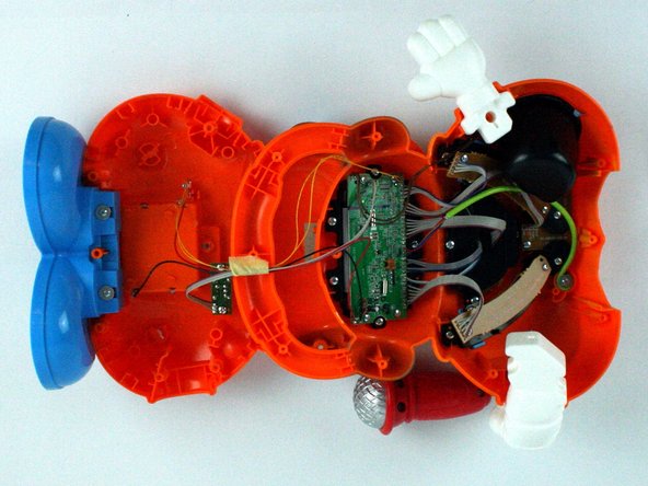

  4. VTech Learning Tunes Karaoke Mode Selector Replacement: crwdns2935265:04crwdnd2935265:01crwdnd2935265:02crwdne2935265:0 VTech Learning Tunes Karaoke Mode Selector Replacement: crwdns2935265:04crwdnd2935265:02crwdnd2935265:02crwdne2935265:0
    • Gently pull up on the rear panel.
    • Be careful to not pull on the wire connections.
    • Gently place the back panel underneath the top panel with the tops facing each other, as shown in the picture.
  5. VTech Learning Tunes Karaoke Mode Selector Replacement: crwdns2935265:05crwdnd2935265:01crwdnd2935265:01crwdne2935265:0
    • Remove the two 7.9 mm Phillips #1 mode switch board screws.
  6. VTech Learning Tunes Karaoke Mode Selector Replacement: crwdns2935265:06crwdnd2935265:01crwdnd2935265:02crwdne2935265:0 VTech Learning Tunes Karaoke Mode Selector Replacement: crwdns2935265:06crwdnd2935265:02crwdnd2935265:02crwdne2935265:0
    • Once the screws have been removed, carefully move the mode switch board to expose the mode switch assembly underneath.
  7. VTech Learning Tunes Karaoke Mode Selector Replacement: crwdns2935265:07crwdnd2935265:01crwdnd2935265:02crwdne2935265:0 VTech Learning Tunes Karaoke Mode Selector Replacement: crwdns2935265:07crwdnd2935265:02crwdnd2935265:02crwdne2935265:0
    • Using a Philips #1 screwdriver, remove the two 5.6 mm screws on the switch.
    • Once the screws have been removed, you can easily remove the mode switch.
