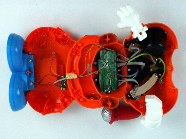

    • To remove the battery door, loosen the screw using a Flathead screwdriver.
    • A coin can also be used to loosen the screw.
  2. VTech Learning Tunes Karaoke LCD Screen Replacement: crwdns2935265:02crwdnd2935265:01crwdnd2935265:02crwdne2935265:0 VTech Learning Tunes Karaoke LCD Screen Replacement: crwdns2935265:02crwdnd2935265:02crwdnd2935265:02crwdne2935265:0
    • Remove the battery door and take out the batteries.
  3. VTech Learning Tunes Karaoke LCD Screen Replacement: crwdns2935265:03crwdnd2935265:01crwdnd2935265:01crwdne2935265:0
    • Remove the six 9.5 mm Phillips #2 screws.
    • Remove the six 6.0 mm Phillips #2 screws.
  4. VTech Learning Tunes Karaoke LCD Screen Replacement: crwdns2935265:04crwdnd2935265:01crwdnd2935265:02crwdne2935265:0 VTech Learning Tunes Karaoke LCD Screen Replacement: crwdns2935265:04crwdnd2935265:02crwdnd2935265:02crwdne2935265:0
    • Gently pull up on the rear panel.
    • Be careful to not pull on the wire connections.
    • Gently place the back panel underneath the top panel with the tops facing each other, as shown in the picture.
  5. VTech Learning Tunes Karaoke LCD Screen Replacement: crwdns2935265:05crwdnd2935265:01crwdnd2935265:01crwdne2935265:0
  6. VTech Learning Tunes Karaoke LCD Screen Replacement: crwdns2935265:06crwdnd2935265:01crwdnd2935265:01crwdne2935265:0
    • Using Phillips #1 screwdriver, remove the four 7.9 mm LCD board screws.
  7. VTech Learning Tunes Karaoke LCD Screen Replacement: crwdns2935265:07crwdnd2935265:01crwdnd2935265:01crwdne2935265:0
    • Remove old board and screen.
