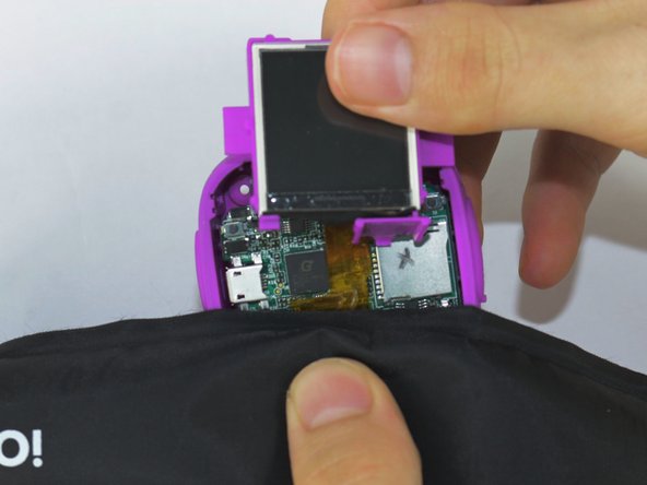

  7. VTech Kidizoom Action Cam LCD Screen Replacement: crwdns2935265:07crwdnd2935265:01crwdnd2935265:03crwdne2935265:0 VTech Kidizoom Action Cam LCD Screen Replacement: crwdns2935265:07crwdnd2935265:02crwdnd2935265:03crwdne2935265:0 VTech Kidizoom Action Cam LCD Screen Replacement: crwdns2935265:07crwdnd2935265:03crwdnd2935265:03crwdne2935265:0
    • Use the plastic opening tool to lift the LCD screen, including the purple casing and set it aside, revealing the motherboard and connector ribbon.
    • Exercise caution while performing this step, as any excessive pulling may tear the connector ribbon from the motherboard.

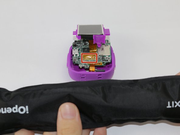

  8. VTech Kidizoom Action Cam LCD Screen Replacement, LCD Screen: crwdns2935265:08crwdnd2935265:01crwdnd2935265:03crwdne2935265:0 VTech Kidizoom Action Cam LCD Screen Replacement, LCD Screen: crwdns2935265:08crwdnd2935265:02crwdnd2935265:03crwdne2935265:0 VTech Kidizoom Action Cam LCD Screen Replacement, LCD Screen: crwdns2935265:08crwdnd2935265:03crwdnd2935265:03crwdne2935265:0
    • Heat the iOpener tool, then press the iOpener tool onto the connectors to heat the glue on the connector ribbon.
    • If the iOpener tool is not available, use a hair dryer to heat the glue on the connector ribbon and then use a Q-tip dabbed in Isopropyl alcohol to dab the heated glue.
  9. VTech Kidizoom Action Cam LCD Screen Replacement: crwdns2935265:09crwdnd2935265:01crwdnd2935265:01crwdne2935265:0
    • Gently peel the connector ribbon being held down by the heated glue until it is completely removed.
    • Be cautious of very hot glue when peeling the connector ribbon off of the motherboard
