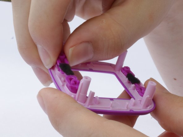

  8. VTech Kidizoom Action Cam Buttons Replacement, Buttons: crwdns2935265:08crwdnd2935265:01crwdnd2935265:02crwdne2935265:0 VTech Kidizoom Action Cam Buttons Replacement, Buttons: crwdns2935265:08crwdnd2935265:02crwdnd2935265:02crwdne2935265:0
    • Push out the buttons that you wish to take out, and replace them with the new buttons.
    • Cleaning the buttons may fix the issue of sticky buttons, and a replacement may not be necessary.
