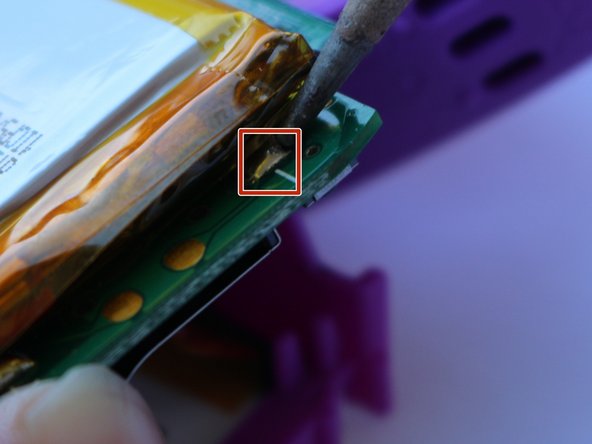

  8. VTech Kidizoom Action Cam Battery Replacement, Battery: crwdns2935265:08crwdnd2935265:01crwdnd2935265:02crwdne2935265:0 VTech Kidizoom Action Cam Battery Replacement, Battery: crwdns2935265:08crwdnd2935265:02crwdnd2935265:02crwdne2935265:0
    • Use the soldering iron to unsolder the battery wires connected to the motherboard by reheating the existing solder.
    • Do not cut the two wires at the same time as this can result in shocks.
    • Soldering Iron will be very hot and can be dangerous to touch.
  9. VTech Kidizoom Action Cam Battery Replacement: crwdns2935265:09crwdnd2935265:01crwdnd2935265:01crwdne2935265:0
