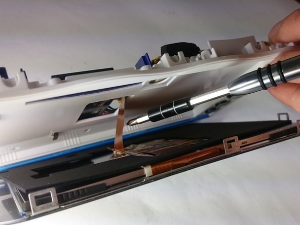

    • Now that all of the screws have been removed, pry the back cover off using a plastic opening tool.
  4. VTech InnoTab Max Motherboard Replacement: crwdns2935265:04crwdnd2935265:01crwdnd2935265:02crwdne2935265:0 VTech InnoTab Max Motherboard Replacement: crwdns2935265:04crwdnd2935265:02crwdnd2935265:02crwdne2935265:0

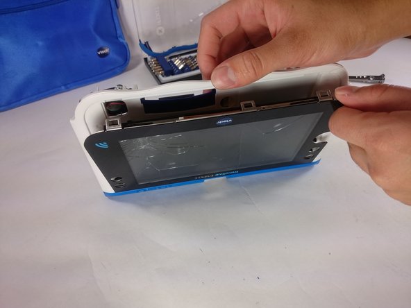

    • Here you can see the back cover has been fully removed and you can now access the front cover.
    • To remove the front cover, remove the springs holding the pictured brackets in place, then pull it away.

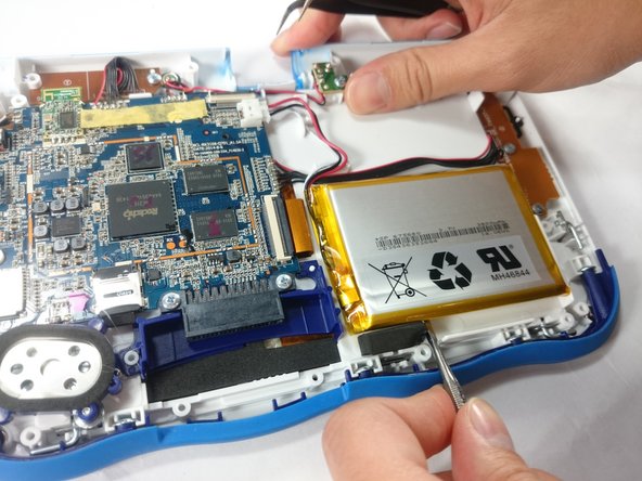

    • Remove the tape holding down the wires, and carefully pry the battery off of the base of the device.
    • Pry carefully to avoid damaging the battery. The battery may start to bend slightly, this is normal and not a cause for concern.
    • It is best to use a plastic card or nylon spudger to remove the battery. Metal tools can puncture a battery, potentially causing a fire.

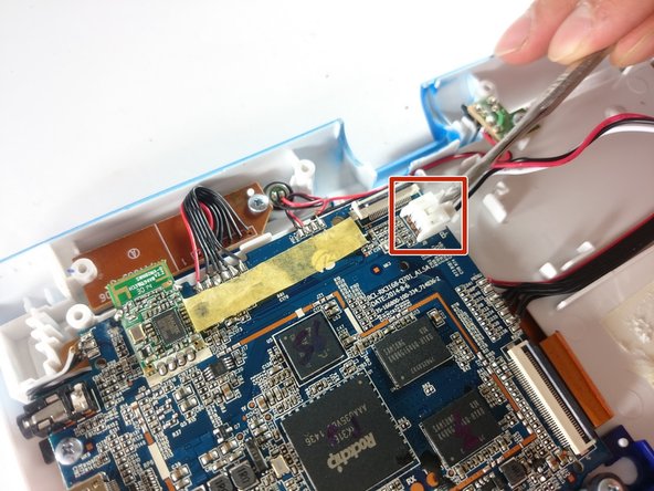

    • Now that the battery is free to be moved, unplug the wire connecting the battery to the motherboard.

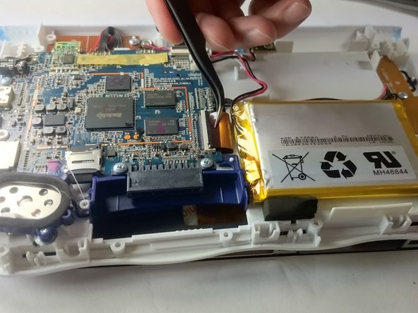

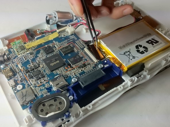

  14. VTech InnoTab Max Motherboard Replacement: crwdns2935265:014crwdnd2935265:01crwdnd2935265:03crwdne2935265:0 VTech InnoTab Max Motherboard Replacement: crwdns2935265:014crwdnd2935265:02crwdnd2935265:03crwdne2935265:0 VTech InnoTab Max Motherboard Replacement: crwdns2935265:014crwdnd2935265:03crwdnd2935265:03crwdne2935265:0
    • In order to completely remove the screen you need to unclip the film from the motherboard by simply using a pair of tweezers and gently pulling.
    • Be careful not to tear the film when pulling.

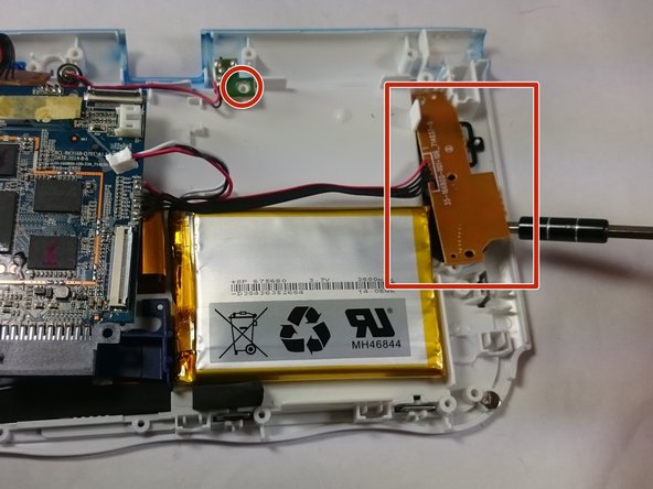

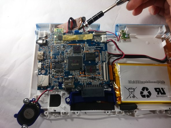

  16. VTech InnoTab Max Motherboard Replacement, Motherboard: crwdns2935265:016crwdnd2935265:01crwdnd2935265:01crwdne2935265:0
    • Remove the circled screws that are holding down the motherboard and components.
    • Every component that will need to be unscrewed will have wires running to it from the motherboard. These wires will not be disconnected.

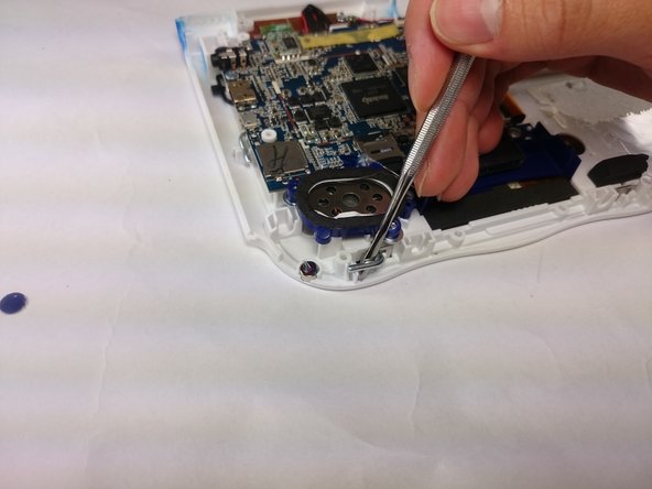

  17. VTech InnoTab Max Motherboard Replacement: crwdns2935265:017crwdnd2935265:01crwdnd2935265:03crwdne2935265:0 VTech InnoTab Max Motherboard Replacement: crwdns2935265:017crwdnd2935265:02crwdnd2935265:03crwdne2935265:0 VTech InnoTab Max Motherboard Replacement: crwdns2935265:017crwdnd2935265:03crwdnd2935265:03crwdne2935265:0
    • With all of the screws out, lift up the speaker, the two visible bronze plates, and the small green chip at the top.
    • Do not try to disconnect any of the wires running to these devices, as you will not be able to reconnect them.
    • All of these components can be located by following wires leaving the motherboard.
