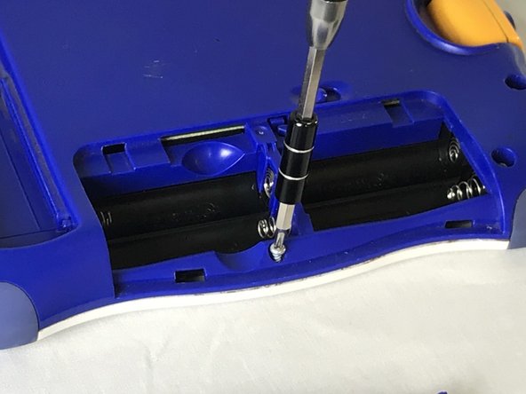

    2. VTech InnoTab 2 Camera Replacement: crwdns2935265:03crwdnd2935265:01crwdnd2935265:03crwdne2935265:0 VTech InnoTab 2 Camera Replacement: crwdns2935265:03crwdnd2935265:02crwdnd2935265:03crwdne2935265:0 VTech InnoTab 2 Camera Replacement: crwdns2935265:03crwdnd2935265:03crwdnd2935265:03crwdne2935265:0
      • Remove the hard rubber tab located by the cartridge slot using the plastic opening tool.
      • Be careful not to apply excessive force.
      • Once the rubber tab is removed unscrew the single 7 mm screw using a J0 screwdriver.

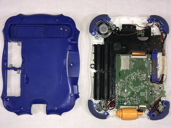

    4. VTech InnoTab 2 Camera Replacement: crwdns2935265:05crwdnd2935265:01crwdnd2935265:02crwdne2935265:0 VTech InnoTab 2 Camera Replacement: crwdns2935265:05crwdnd2935265:02crwdnd2935265:02crwdne2935265:0
      • Using the plastic opening tool, detach the back plate from the front piece.
      • Do not use excessive force. If the back plate does not gently come on double check that all screws were removed.
      • Once the back panel is removed, you will be able to see the motherboard and other components within the device.

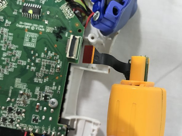

    1. VTech InnoTab 2 Camera Replacement, Camera: crwdns2935265:06crwdnd2935265:01crwdnd2935265:03crwdne2935265:0 VTech InnoTab 2 Camera Replacement, Camera: crwdns2935265:06crwdnd2935265:02crwdnd2935265:03crwdne2935265:0 VTech InnoTab 2 Camera Replacement, Camera: crwdns2935265:06crwdnd2935265:03crwdnd2935265:03crwdne2935265:0
      • Using the tip of your finger, carefully pull the clip upwards to release the camera connection from the motherboard.
      • The connection to the camera is located on top side of the devices motherboard.
      • Pulling the camera while the connection to the motherboard is still intact can cause damage to the circuit board.
      • Attach the replacement camera and lower the latch until a click sound can be heard.
