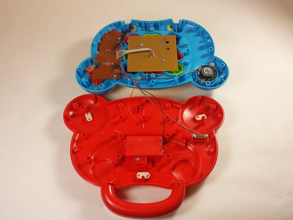

    • Remove the rear panel screws using a Phillips #2 screwdriver.
    • Two 21.6mm (Long)
    • One 9.8mm (Short)
    • Five 13.8mm (Medium)
  4. VTech Baby's Learning Laptop Speaker Replacement: crwdns2935265:04crwdnd2935265:01crwdnd2935265:02crwdne2935265:0 VTech Baby's Learning Laptop Speaker Replacement: crwdns2935265:04crwdnd2935265:02crwdnd2935265:02crwdne2935265:0
    • Gently pull up on the rear panel.
    • Be careful not to pull on the wire connections.
    • Rest the laptop open on the table.

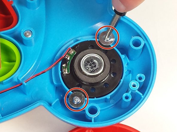

  5. VTech Baby's Learning Laptop Speaker Replacement, Speaker: crwdns2935265:05crwdnd2935265:01crwdnd2935265:02crwdne2935265:0 VTech Baby's Learning Laptop Speaker Replacement, Speaker: crwdns2935265:05crwdnd2935265:02crwdnd2935265:02crwdne2935265:0
    • Use a Phillips #0 screwdriver to unscrew the two 6.0 mm screws on the speaker.

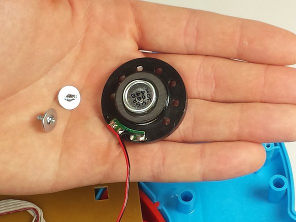

  6. VTech Baby's Learning Laptop Speaker Replacement: crwdns2935265:06crwdnd2935265:01crwdnd2935265:02crwdne2935265:0 VTech Baby's Learning Laptop Speaker Replacement: crwdns2935265:06crwdnd2935265:02crwdnd2935265:02crwdne2935265:0
    • Remove the two 6 mm screws from the device.
    • Remove the speaker.
    • Be careful not to damage the wiring.
