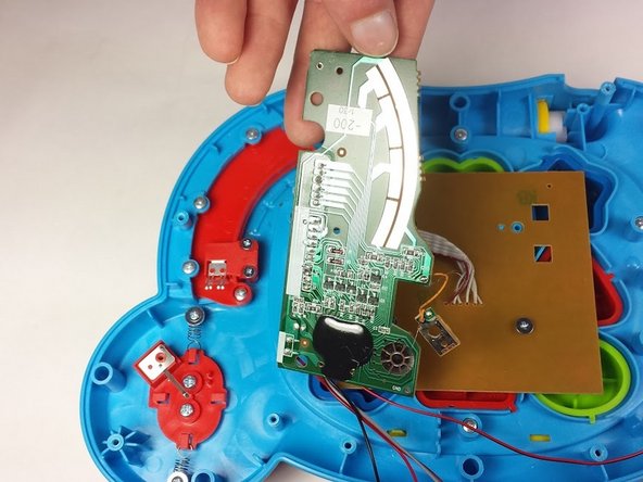

  5. VTech Baby's Learning Laptop Mode Switch Replacement, Mode Switch: crwdns2935265:05crwdnd2935265:01crwdnd2935265:02crwdne2935265:0 VTech Baby's Learning Laptop Mode Switch Replacement, Mode Switch: crwdns2935265:05crwdnd2935265:02crwdnd2935265:02crwdne2935265:0
    • Using a Phillips #0 screwdriver, remove the three 7.3mm screws.
  6. VTech Baby's Learning Laptop Mode Switch Replacement: crwdns2935265:06crwdnd2935265:01crwdnd2935265:03crwdne2935265:0 VTech Baby's Learning Laptop Mode Switch Replacement: crwdns2935265:06crwdnd2935265:02crwdnd2935265:03crwdne2935265:0 VTech Baby's Learning Laptop Mode Switch Replacement: crwdns2935265:06crwdnd2935265:03crwdnd2935265:03crwdne2935265:0
    • Once the screws have been removed from the board, use a plastic opening tool to gently pry up the board and expose the mode switch assembly underneath.
    • Lay the board down gently and out of the way.
    • Take care not to damage any of the wires or the board itself.
