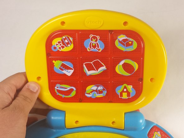

    3. VTech Baby's Learning Laptop LEDs Replacement: crwdns2935265:03crwdnd2935265:01crwdnd2935265:02crwdne2935265:0 VTech Baby's Learning Laptop LEDs Replacement: crwdns2935265:03crwdnd2935265:02crwdnd2935265:02crwdne2935265:0
      • Using a Phillips #0 screwdriver, unscrew the six 7.3mm screws holding the screen together.

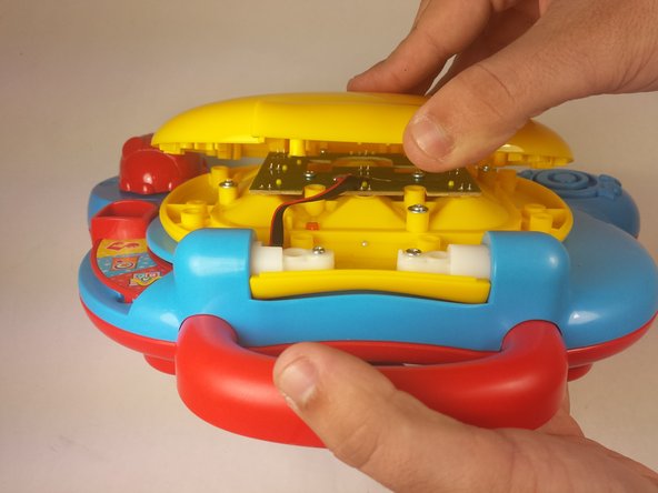

    4. VTech Baby's Learning Laptop LEDs Replacement: crwdns2935265:04crwdnd2935265:01crwdnd2935265:03crwdne2935265:0 VTech Baby's Learning Laptop LEDs Replacement: crwdns2935265:04crwdnd2935265:02crwdnd2935265:03crwdne2935265:0 VTech Baby's Learning Laptop LEDs Replacement: crwdns2935265:04crwdnd2935265:03crwdnd2935265:03crwdne2935265:0
      • With the lid closed, position the device such that the handle is pointing towards you.
      • Using your fingers, gently pry open the cover from the hinge.
      • Attempting to remove the cover while the lid is still open may cause unwanted damage to the device.

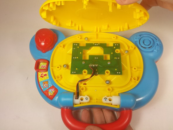

    5. VTech Baby's Learning Laptop LEDs Replacement: crwdns2935265:05crwdnd2935265:01crwdnd2935265:01crwdne2935265:0
      • Remove two 6.0mm screws from the LED array using a Phillips #0 screwdriver.
    6. VTech Baby's Learning Laptop LEDs Replacement: crwdns2935265:06crwdnd2935265:01crwdnd2935265:01crwdne2935265:0
      • Pickup the array by the opening in the center of the board.
      • Remove the faulty LEDs by desoldering each from the board. You may refer to this soldering guide if necessary.
      • Movement of the array will be limited as it is still attached to the main device board.
