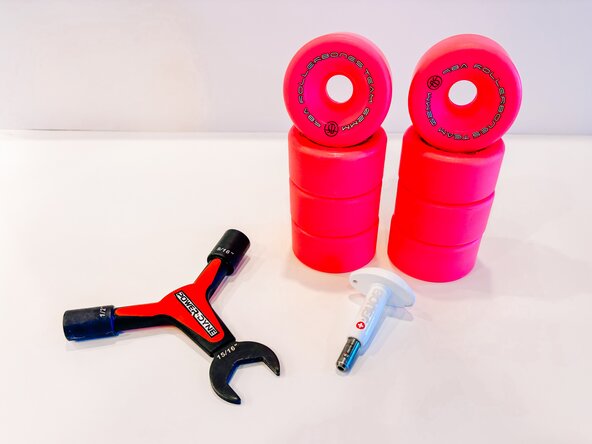

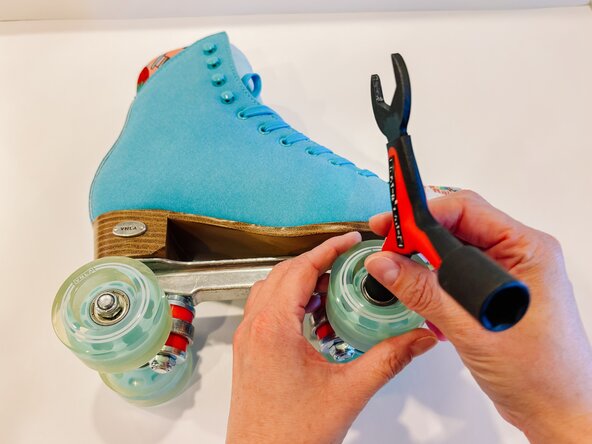

    • Place your skates on a flat surface for stability.
    • Ensure you have your new wheels and necessary tools within reach.

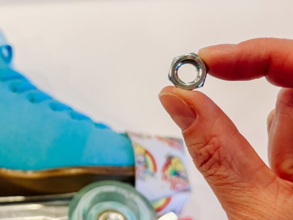

  2. VNLA Parfait Skates Wheel Replacement: crwdns2935265:02crwdnd2935265:01crwdnd2935265:03crwdne2935265:0 VNLA Parfait Skates Wheel Replacement: crwdns2935265:02crwdnd2935265:02crwdnd2935265:03crwdne2935265:0 VNLA Parfait Skates Wheel Replacement: crwdns2935265:02crwdnd2935265:03crwdnd2935265:03crwdne2935265:0
    • Use the PowerDyne Y3 Skate Tool to loosen the axle nuts on the first wheel by turning counterclockwise.
    • Keep the nuts in a safe place, as you will reuse them.
  3. VNLA Parfait Skates Wheel Replacement: crwdns2935265:03crwdnd2935265:01crwdnd2935265:02crwdne2935265:0 VNLA Parfait Skates Wheel Replacement: crwdns2935265:03crwdnd2935265:02crwdnd2935265:02crwdne2935265:0
    • Slide the old wheel straight off the axle once the nut is removed.
    • Repeat the process for all wheels.

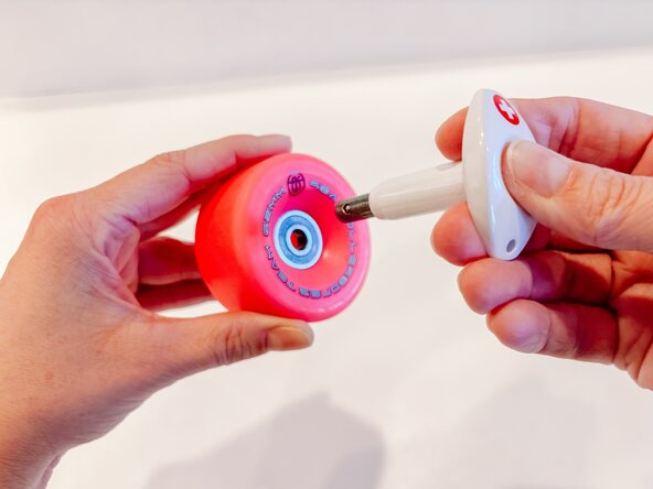

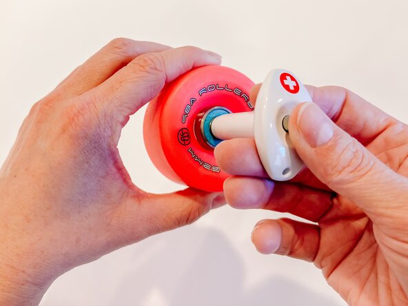

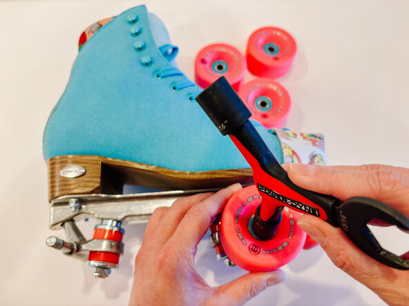

  4. VNLA Parfait Skates Wheel Replacement: crwdns2935265:04crwdnd2935265:01crwdnd2935265:03crwdne2935265:0 VNLA Parfait Skates Wheel Replacement: crwdns2935265:04crwdnd2935265:02crwdnd2935265:03crwdne2935265:0 VNLA Parfait Skates Wheel Replacement: crwdns2935265:04crwdnd2935265:03crwdnd2935265:03crwdne2935265:0
    • Place a bearing into the Bones Bearing Press/Puller and align it with the center of the new wheel.
    • Press down evenly and firmly until the bearing is fully seated.
    • Flip the wheel and repeat for the second bearing.
    • Do this for all wheels.

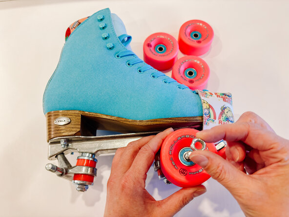

  5. VNLA Parfait Skates Wheel Replacement: crwdns2935265:05crwdnd2935265:01crwdnd2935265:03crwdne2935265:0 VNLA Parfait Skates Wheel Replacement: crwdns2935265:05crwdnd2935265:02crwdnd2935265:03crwdne2935265:0 VNLA Parfait Skates Wheel Replacement: crwdns2935265:05crwdnd2935265:03crwdnd2935265:03crwdne2935265:0
    • Slide the new wheels onto the skate axles.
    • Secure each wheel with the axle nut, turning it clockwise with the PowerDyne Y3 Skate Tool.

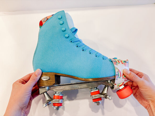

  6. VNLA Parfait Skates Wheel Replacement: crwdns2935265:06crwdnd2935265:01crwdnd2935265:01crwdne2935265:0
    • Spin each wheel by hand to check for smooth rotation.
    • If a wheel is too tight, slightly loosen the axle nut.
    • If it’s too loose, tighten it just enough to prevent wobbling.
