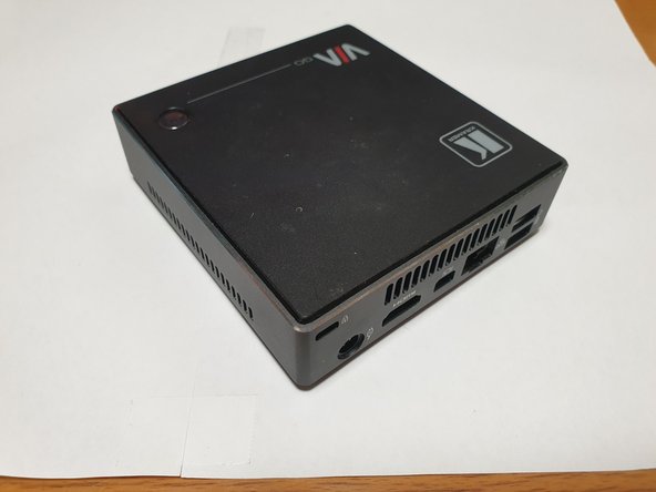

  1. VIA GO Teardown, Overview: crwdns2935265:01crwdnd2935265:01crwdnd2935265:03crwdne2935265:0 VIA GO Teardown, Overview: crwdns2935265:01crwdnd2935265:02crwdnd2935265:03crwdne2935265:0 VIA GO Teardown, Overview: crwdns2935265:01crwdnd2935265:03crwdnd2935265:03crwdne2935265:0
    • USB and audio ports at front and rest of I/O are at the back. power button is on top.

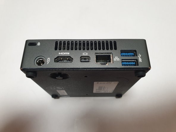

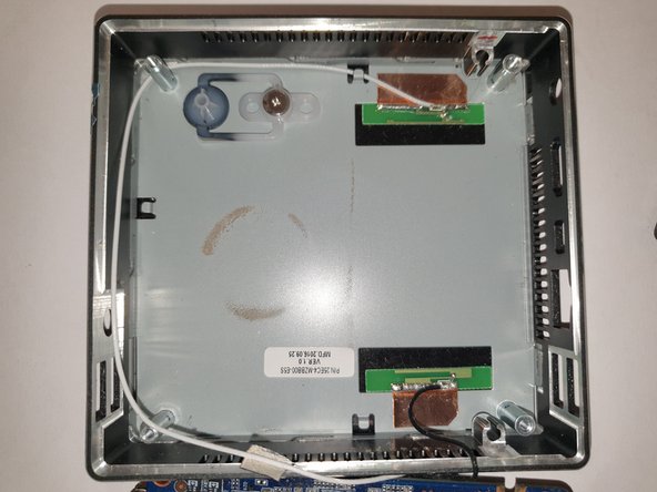

  2. VIA GO Teardown, bottom screws: crwdns2935265:02crwdnd2935265:01crwdnd2935265:01crwdne2935265:0
    • Remove four (phillips) screws on the bottom of the device, these are located inside of rubber feet.

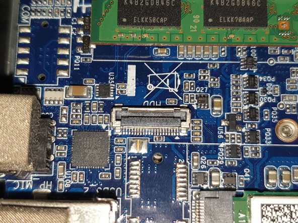

  3. VIA GO Teardown, motherboard: crwdns2935265:03crwdnd2935265:01crwdnd2935265:03crwdne2935265:0 VIA GO Teardown, motherboard: crwdns2935265:03crwdnd2935265:02crwdnd2935265:03crwdne2935265:0 VIA GO Teardown, motherboard: crwdns2935265:03crwdnd2935265:03crwdnd2935265:03crwdne2935265:0
    • remove screws that hold motherboard in the case.
    • LPDDR3 slot (there is no internal memory).
    • M.2 slot with Intel 3160NGW (Dual-band AC-WiFi + BT)
    • 20-pin connector for external SATA hard drive.

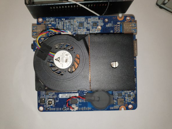

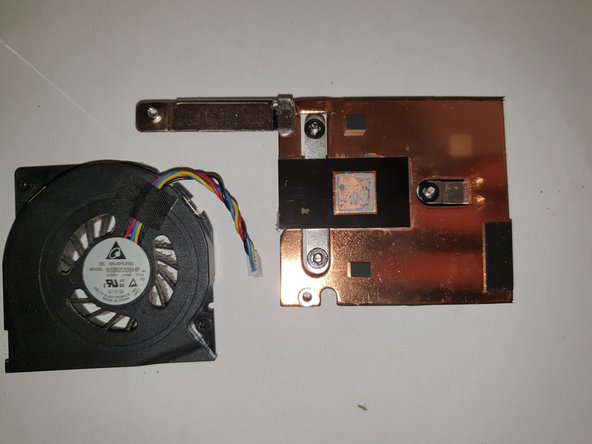

  4. VIA GO Teardown, CPU and heatsink: crwdns2935265:04crwdnd2935265:01crwdnd2935265:03crwdne2935265:0 VIA GO Teardown, CPU and heatsink: crwdns2935265:04crwdnd2935265:02crwdnd2935265:03crwdne2935265:0 VIA GO Teardown, CPU and heatsink: crwdns2935265:04crwdnd2935265:03crwdnd2935265:03crwdne2935265:0
    • screws to remove fan assembly
    • screws to remove heatsink
    • RTC battery
    • eMMC (SD) chip
    • power button

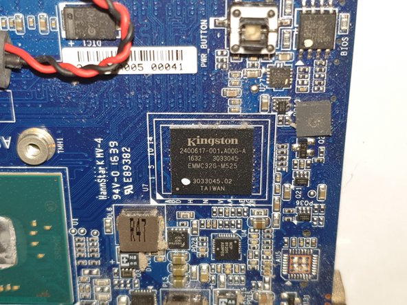

  5. VIA GO Teardown, CPU without heatsink: crwdns2935265:05crwdnd2935265:01crwdnd2935265:02crwdne2935265:0 VIA GO Teardown, CPU without heatsink: crwdns2935265:05crwdnd2935265:02crwdnd2935265:02crwdne2935265:0
    • closeup of Intel N3010 SoC and eMMC chip.

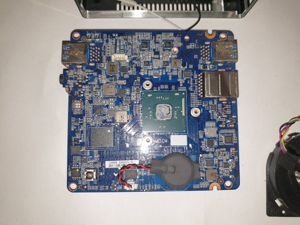

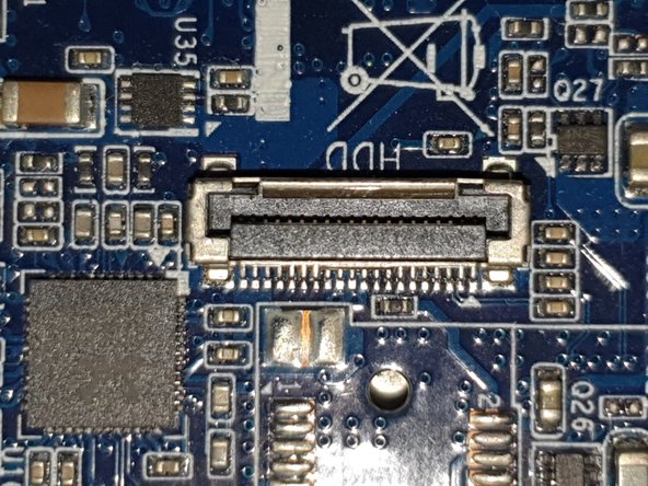

  6. VIA GO Teardown, motherboard (without memory): crwdns2935265:06crwdnd2935265:01crwdnd2935265:03crwdne2935265:0 VIA GO Teardown, motherboard (without memory): crwdns2935265:06crwdnd2935265:02crwdnd2935265:03crwdne2935265:0 VIA GO Teardown, motherboard (without memory): crwdns2935265:06crwdnd2935265:03crwdnd2935265:03crwdne2935265:0
    • component overview. also closeup of 20-pin external sata connector.
