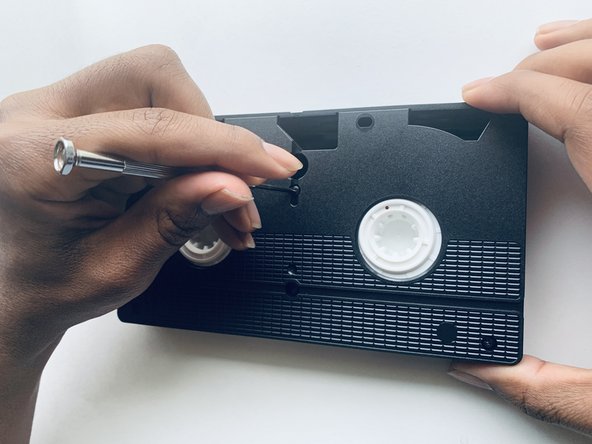

In this guide, you will learn step-by-step instructions on how to replace the broken shell of a VHS tape when it is too broken to work correctly in a VHS player. In doing this repair, you will be able to salvage the tape so that it can be digitized or continue to be watched. No special skills are needed for this repair, with a screwdriver being the only tool used. It is recommended that you cut or rip off any labels on the sides of the tape before beginning, so that it will be easier to take the top half of the shell off.
    1. VHS Shell Replacement, Plastic Shell: crwdns2935265:01crwdnd2935265:01crwdnd2935265:02crwdne2935265:0 VHS Shell Replacement, Plastic Shell: crwdns2935265:01crwdnd2935265:02crwdnd2935265:02crwdne2935265:0
      • Unscrew the five 3mm screws with the Phillips #1 screwdriver.
    2. VHS Shell Replacement: crwdns2935265:02crwdnd2935265:01crwdnd2935265:01crwdne2935265:0
      • Once the screws are out, pull off the front of the VHS shell.
      • Take off any labels on the sides of tape before doing this step.
      • Make sure you are taking off the front of the shell, otherwise the reels or other loose pieces may fall out.

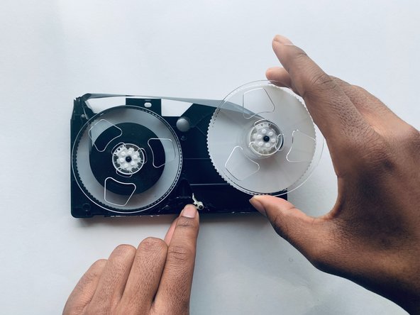

    3. VHS Shell Replacement: crwdns2935265:03crwdnd2935265:01crwdnd2935265:02crwdne2935265:0 VHS Shell Replacement: crwdns2935265:03crwdnd2935265:02crwdnd2935265:02crwdne2935265:0
      • Hold down on the white lever.
      • While holding down, carefully take out the reel on the right.
      • Take out the left reel and set them both aside, with the tape still wrapped inside and connecting them.
