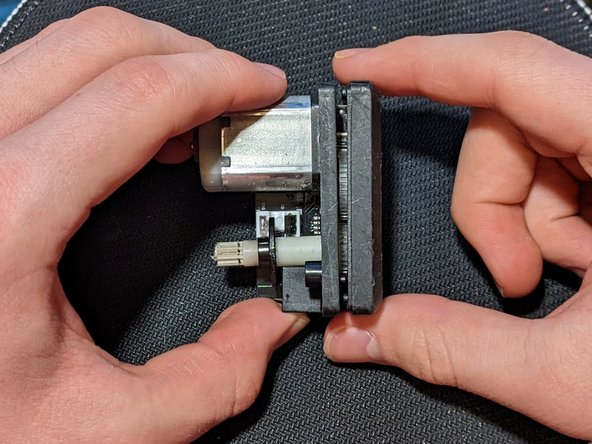

  2. VEX V5 11w smart motor Un-seizing, remove main case: crwdns2935265:02crwdnd2935265:01crwdnd2935265:03crwdne2935265:0 VEX V5 11w smart motor Un-seizing, remove main case: crwdns2935265:02crwdnd2935265:02crwdnd2935265:03crwdne2935265:0 VEX V5 11w smart motor Un-seizing, remove main case: crwdns2935265:02crwdnd2935265:03crwdnd2935265:03crwdne2935265:0
    • Remove the 4 screws holding the top case on the motor.
    • Once the screws are removed you can pull the 2 pieces apart.

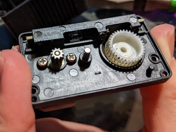

  3. VEX V5 11w smart motor Un-seizing, remove bottom gear cover: crwdns2935265:03crwdnd2935265:01crwdnd2935265:03crwdne2935265:0 VEX V5 11w smart motor Un-seizing, remove bottom gear cover: crwdns2935265:03crwdnd2935265:02crwdnd2935265:03crwdne2935265:0 VEX V5 11w smart motor Un-seizing, remove bottom gear cover: crwdns2935265:03crwdnd2935265:03crwdnd2935265:03crwdne2935265:0
    • Remove the 2 Phillips head screws holding the bottom case on.
    • Pull the bottom case off.

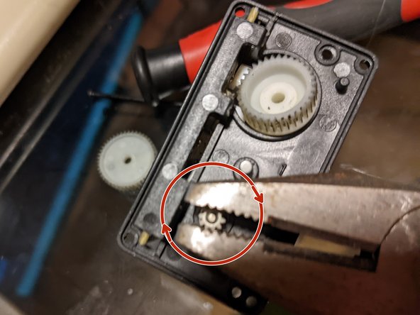

  4. VEX V5 11w smart motor Un-seizing, remove center gear: crwdns2935265:04crwdnd2935265:01crwdnd2935265:02crwdne2935265:0 VEX V5 11w smart motor Un-seizing, remove center gear: crwdns2935265:04crwdnd2935265:02crwdnd2935265:02crwdne2935265:0
    • Use your fingers, a small flathead screwdriver, or a spudger to remove the center gear.

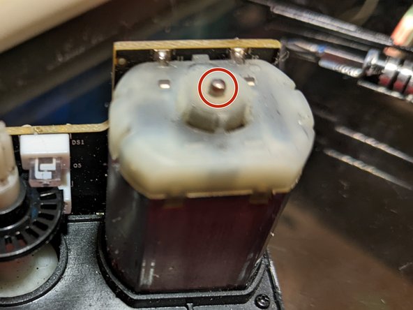

  5. VEX V5 11w smart motor Un-seizing, tap and twist the motor shaft: crwdns2935265:05crwdnd2935265:01crwdnd2935265:03crwdne2935265:0 VEX V5 11w smart motor Un-seizing, tap and twist the motor shaft: crwdns2935265:05crwdnd2935265:02crwdnd2935265:03crwdne2935265:0 VEX V5 11w smart motor Un-seizing, tap and twist the motor shaft: crwdns2935265:05crwdnd2935265:03crwdnd2935265:03crwdne2935265:0
    • 1. Tap the small metal gear and metal shaft on the other side of the motor.
    • 2. Grip the metal gear with pliers and twist 1 full revolution or until the motor spins freely by hand.
