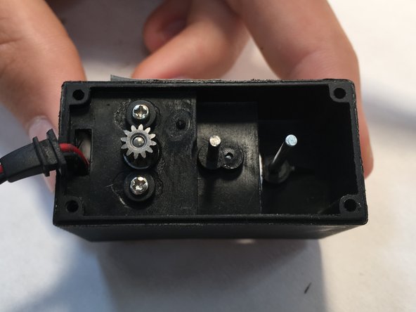

    • Disconnect the motor from any other connected devices or power sources.
    • Use a Small Phillips Head Screwdriver to unscrew the four screws from the black casing's corners.
  2. VEX Robotics VEX EDR 393 Gear Replacement: crwdns2935265:02crwdnd2935265:01crwdnd2935265:01crwdne2935265:0
    • Pull off the black bottom casing.
    • Remove the two gears inside.
  3. VEX Robotics VEX EDR 393 Gear Replacement: crwdns2935265:03crwdnd2935265:01crwdnd2935265:02crwdne2935265:0 VEX Robotics VEX EDR 393 Gear Replacement: crwdns2935265:03crwdnd2935265:02crwdnd2935265:02crwdne2935265:0

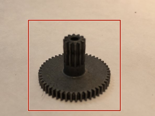

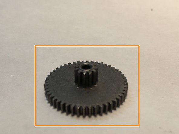

    • Select the replacement gears that match the gears you just removed.
    • Take the gear that has teeth on its entire length and insert it onto the metal pin. Push it all the way into the bottom of the motor. It should connect with a small gear on the bottom.
    • Now, insert the larger gear with teeth on the base onto the circular plastic peg.
    • Make sure the gears are aligned. Spin the top gear with your fingers a few times to double check.
    • Replace the black bottom casing and screws.
    • The screws are susceptible to stripping so do not over-tighten them.
