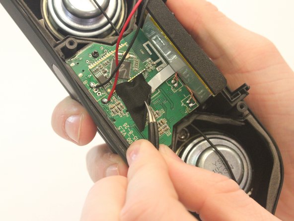

      • Remove the black fabric covering the logic board.
    3. VENSTAR Taco Speaker Replacement Replacement: crwdns2935265:08crwdnd2935265:01crwdnd2935265:02crwdne2935265:0 VENSTAR Taco Speaker Replacement Replacement: crwdns2935265:08crwdnd2935265:02crwdnd2935265:02crwdne2935265:0

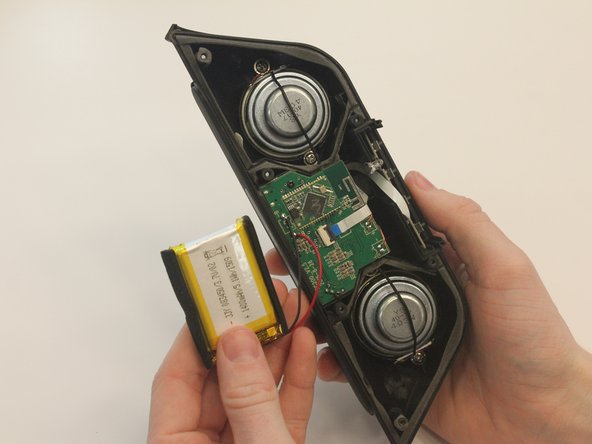

      • Move the battery out of the way of the connector.

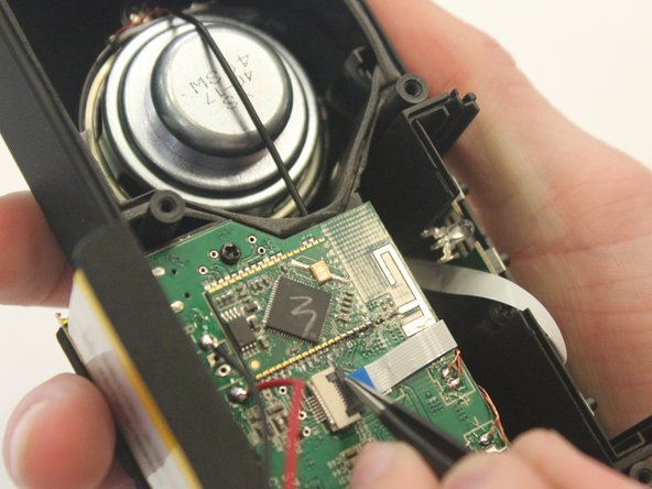

      • Undo the connector of the flat white ribbon between the switches and the logic board.

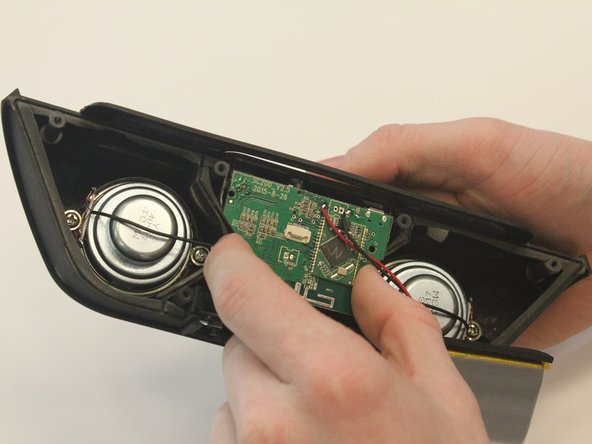

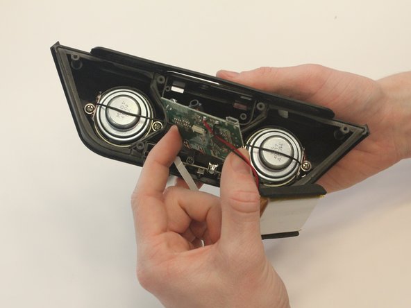

      • Gently pull out the logic board.
      • Note that the battery and the logic board are connected and must be removed together.

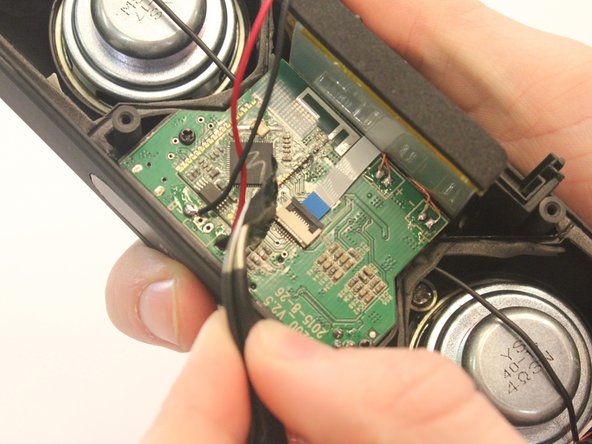

    1. VENSTAR Taco Speaker Replacement Replacement, Speaker Replacement: crwdns2935265:012crwdnd2935265:01crwdnd2935265:02crwdne2935265:0 VENSTAR Taco Speaker Replacement Replacement, Speaker Replacement: crwdns2935265:012crwdnd2935265:02crwdnd2935265:02crwdne2935265:0

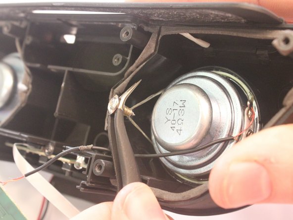

      • Using the Ph1 screwdriver, unscrew both of the 2.5mm screws on either side of the speakers.
      • The screws are glued in and may require the curved tweezers to pull all the way out.
    2. VENSTAR Taco Speaker Replacement Replacement: crwdns2935265:013crwdnd2935265:01crwdnd2935265:01crwdne2935265:0
      • Using a metal spudger, carefully wedge out the speakers from the casing.
      • Repeat this step for the removal of the other speaker.
      • Speakers are glued into the casing beyond being screwed and require some care to remove.
    3. VENSTAR Taco Speaker Replacement Replacement: crwdns2935265:014crwdnd2935265:01crwdnd2935265:01crwdne2935265:0
      • Using a portable soldering iron, melt the solder on the black speaker wires on the logic board.
      • Soldering uses hot metal and can burn you!
Solder your replacement speakers back to mother board, then to reassemble your device, follow these instructions in reverse order.
