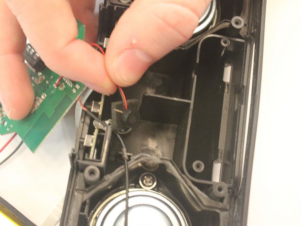

    1. VENSTAR Taco Microphone Replacement Replacement, Microphone Replacement: crwdns2935265:012crwdnd2935265:01crwdnd2935265:02crwdne2935265:0 VENSTAR Taco Microphone Replacement Replacement, Microphone Replacement: crwdns2935265:012crwdnd2935265:02crwdnd2935265:02crwdne2935265:0
      • Below the logic board, the small black microphone is resting within the case.
