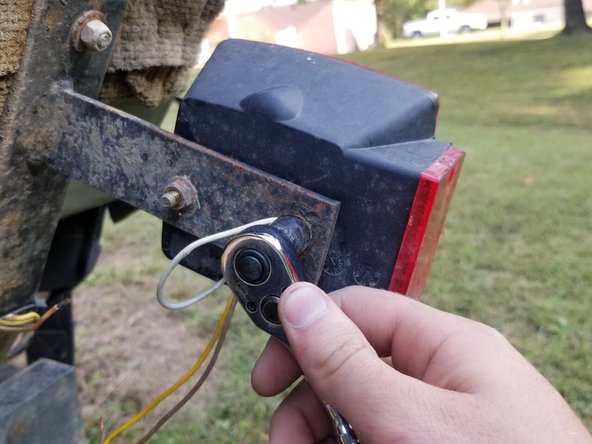

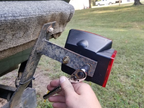

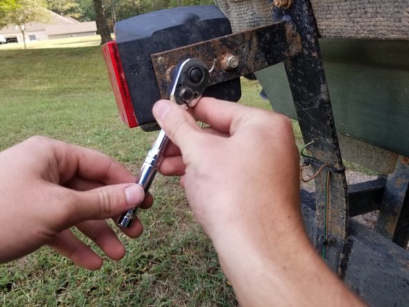

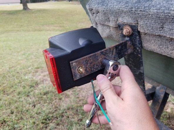

    • Use a ratchet wrench to remove both hex nuts on the bolts mounting the light to the bracket.
  4. Utility Trailer Lights Replacement: crwdns2935265:04crwdnd2935265:01crwdnd2935265:03crwdne2935265:0 Utility Trailer Lights Replacement: crwdns2935265:04crwdnd2935265:02crwdnd2935265:03crwdne2935265:0 Utility Trailer Lights Replacement: crwdns2935265:04crwdnd2935265:03crwdnd2935265:03crwdne2935265:0

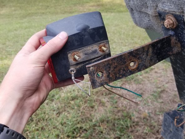

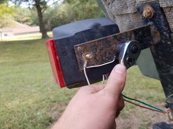

    • Use the ratchet wrench to remove the second set of hex nuts on the bolts from the light going through the mounting bracket.

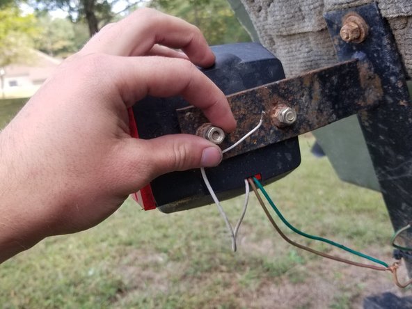

    • Take the white ground wire off of the bolts going through the mounting bracket.

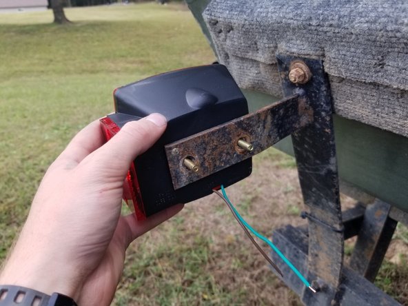

  5. Utility Trailer Lights Replacement: crwdns2935265:05crwdnd2935265:01crwdnd2935265:02crwdne2935265:0 Utility Trailer Lights Replacement: crwdns2935265:05crwdnd2935265:02crwdnd2935265:02crwdne2935265:0

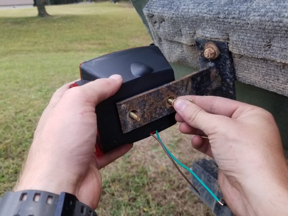

    • Place your thumbs on the bolts of the trailer light and push with even pressure on both bolts.
    • Remove the light and discard it.

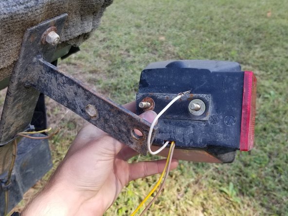

    • Move to the driver side light on the trailer.
    • The process for removing the light on this side is the exact same it is for the light on the passenger side.
    • Follow steps 2-6 for removing the light from the driver side.

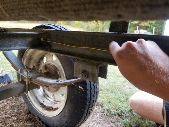

    • Inspect all the wiring on both sides of the trailer itself and closely look at points of contact where the wires could potentially rub and get damaged.
    • The wires should be located in the inner walls of the support beams of the trailer.

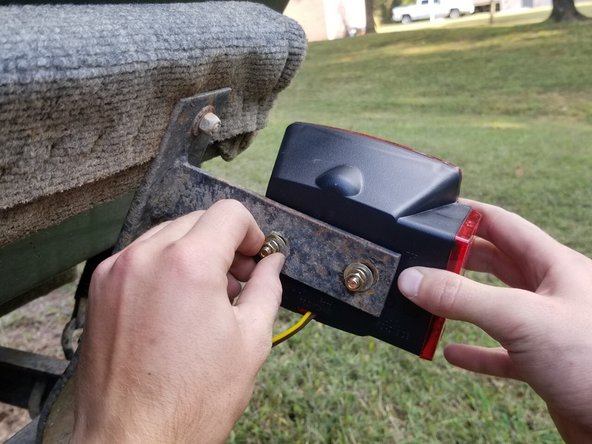

    • Insert the bolts of the passenger side light into the mounting bracket on the trailer.
  9. Utility Trailer Lights Replacement: crwdns2935265:09crwdnd2935265:01crwdnd2935265:03crwdne2935265:0 Utility Trailer Lights Replacement: crwdns2935265:09crwdnd2935265:02crwdnd2935265:03crwdne2935265:0 Utility Trailer Lights Replacement: crwdns2935265:09crwdnd2935265:03crwdnd2935265:03crwdne2935265:0
    • Place a lock washer and a hex nut (included in kit) onto each bolt sticking through the mounting bracket.
    • Tighten each hex nut down with a ratchet wrench.

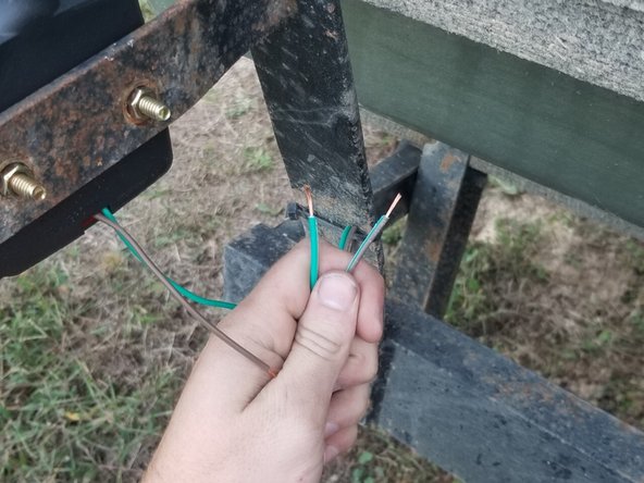

    • Use a pair of wire strippers to strip the ends of the green and brown wire coming from the newly installed light.
  12. Utility Trailer Lights Replacement: crwdns2935265:012crwdnd2935265:01crwdnd2935265:03crwdne2935265:0 Utility Trailer Lights Replacement: crwdns2935265:012crwdnd2935265:02crwdnd2935265:03crwdne2935265:0 Utility Trailer Lights Replacement: crwdns2935265:012crwdnd2935265:03crwdnd2935265:03crwdne2935265:0

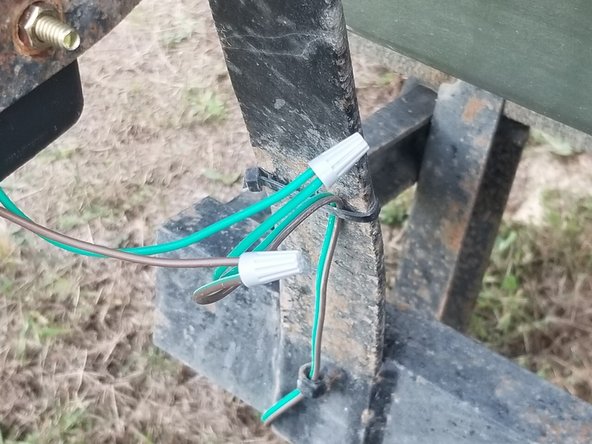

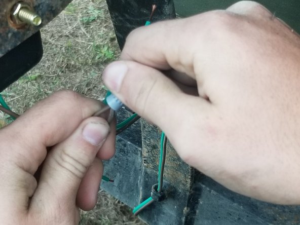

    • Take the ends of both brown wires and twist them together. Do the same thing with both of the green wires.
    • Take a wire nut and screw it onto the brown twisted-together wires. Do the same thing for the green twisted-together wires.
