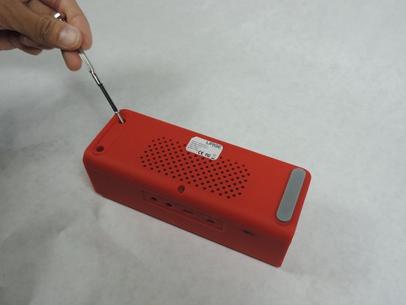

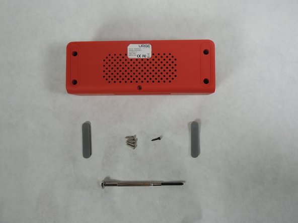

    • Flip the speaker upside down.
    • Unscrew the middle screw with a Philips #1 screwdriver.
  2. Urge Basics Soundbrick Speaker Woofer Replacement: crwdns2935265:02crwdnd2935265:01crwdnd2935265:02crwdne2935265:0 Urge Basics Soundbrick Speaker Woofer Replacement: crwdns2935265:02crwdnd2935265:02crwdnd2935265:02crwdne2935265:0
    • Peel off the two gray tabs to expose the four inner Philips #1 screws.

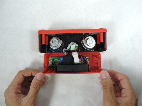

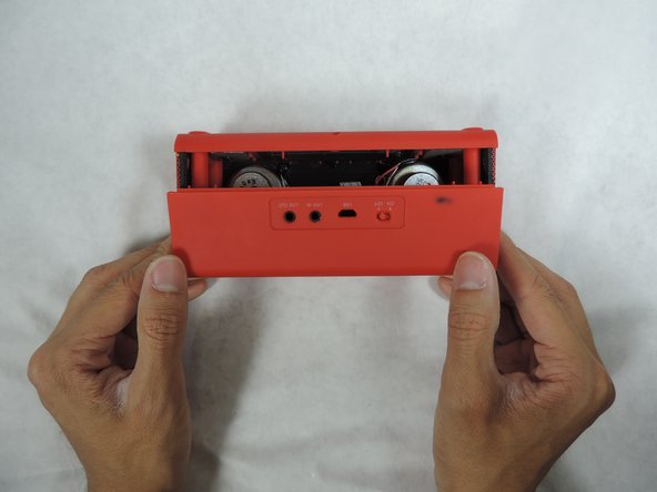

    • Flip the speaker so that the ports are facing up.
    • Unfold the speaker's cover away from the body.

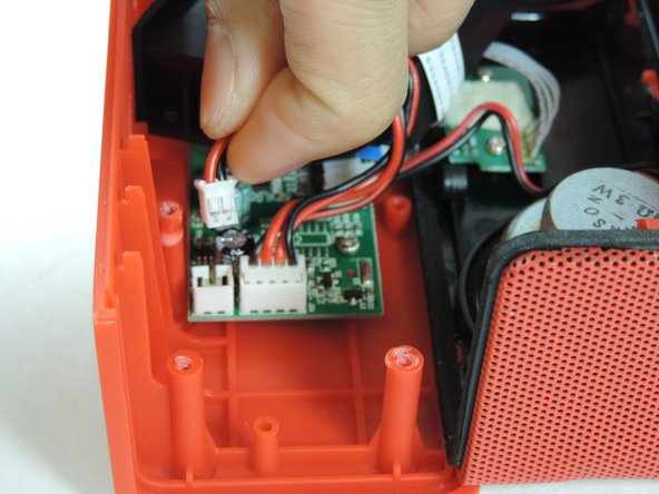

  5. Urge Basics Soundbrick Speaker Woofer Replacement: crwdns2935265:05crwdnd2935265:01crwdnd2935265:02crwdne2935265:0 Urge Basics Soundbrick Speaker Woofer Replacement: crwdns2935265:05crwdnd2935265:02crwdnd2935265:02crwdne2935265:0

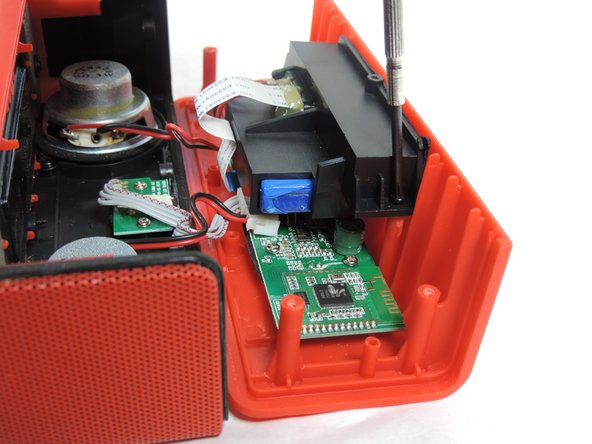

    • Remove the two Phillips #1 screws found on each side of the battery compartment.
    • Removal of battery compartment is necessary to prevent electric shock when replacing the woofer.

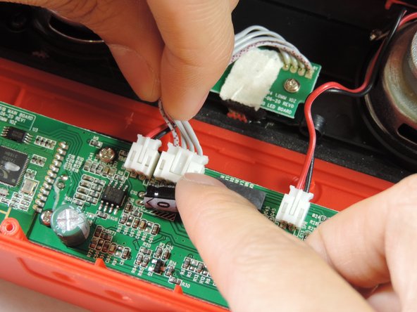

  6. Urge Basics Soundbrick Speaker Woofer Replacement: crwdns2935265:06crwdnd2935265:01crwdnd2935265:03crwdne2935265:0 Urge Basics Soundbrick Speaker Woofer Replacement: crwdns2935265:06crwdnd2935265:02crwdnd2935265:03crwdne2935265:0 Urge Basics Soundbrick Speaker Woofer Replacement: crwdns2935265:06crwdnd2935265:03crwdnd2935265:03crwdne2935265:0
    • Disconnect the battery connectors attached to the circuit board by unplugging them.
  7. Urge Basics Soundbrick Speaker Woofer Replacement: crwdns2935265:07crwdnd2935265:01crwdnd2935265:03crwdne2935265:0 Urge Basics Soundbrick Speaker Woofer Replacement: crwdns2935265:07crwdnd2935265:02crwdnd2935265:03crwdne2935265:0 Urge Basics Soundbrick Speaker Woofer Replacement: crwdns2935265:07crwdnd2935265:03crwdnd2935265:03crwdne2935265:0
    • Disconnect the ribbon cable from the battery by carefully pulling it out.
    • Remove the battery compartment.

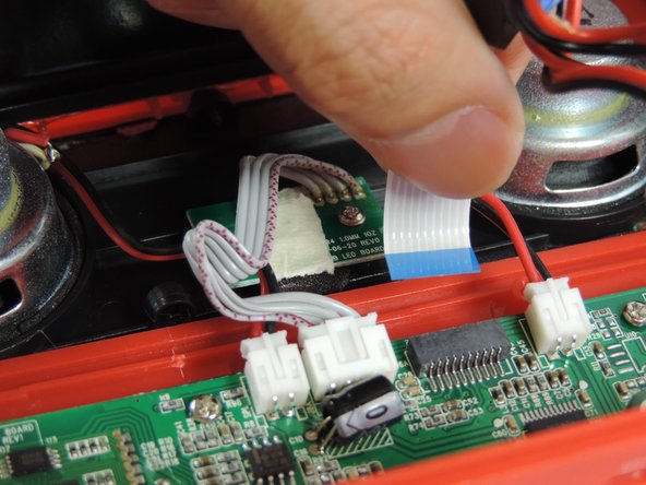

  8. Urge Basics Soundbrick Speaker Woofer Replacement: crwdns2935265:08crwdnd2935265:01crwdnd2935265:03crwdne2935265:0 Urge Basics Soundbrick Speaker Woofer Replacement: crwdns2935265:08crwdnd2935265:02crwdnd2935265:03crwdne2935265:0 Urge Basics Soundbrick Speaker Woofer Replacement: crwdns2935265:08crwdnd2935265:03crwdnd2935265:03crwdne2935265:0

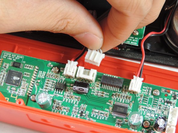

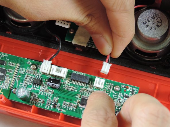

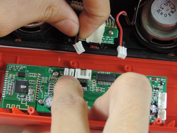

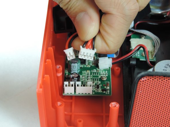

    • Disconnect the adjacent connector from the main circuit board.
  9. Urge Basics Soundbrick Speaker Woofer Replacement: crwdns2935265:09crwdnd2935265:01crwdnd2935265:03crwdne2935265:0 Urge Basics Soundbrick Speaker Woofer Replacement: crwdns2935265:09crwdnd2935265:02crwdnd2935265:03crwdne2935265:0 Urge Basics Soundbrick Speaker Woofer Replacement: crwdns2935265:09crwdnd2935265:03crwdnd2935265:03crwdne2935265:0
    • Disconnect the woofer's two connectors from the main circuit board.

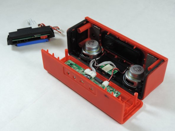

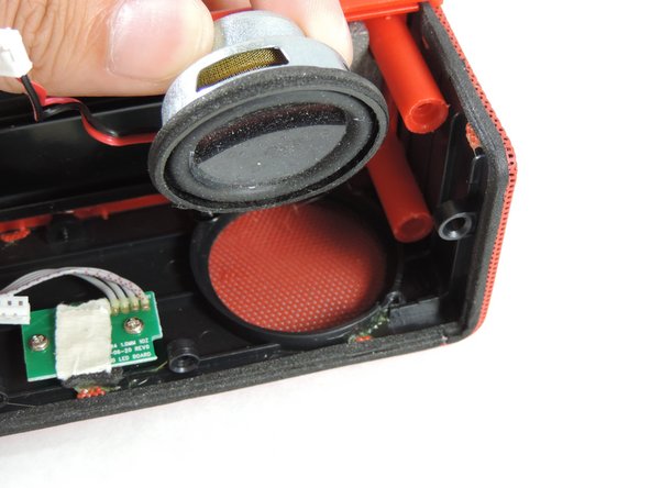

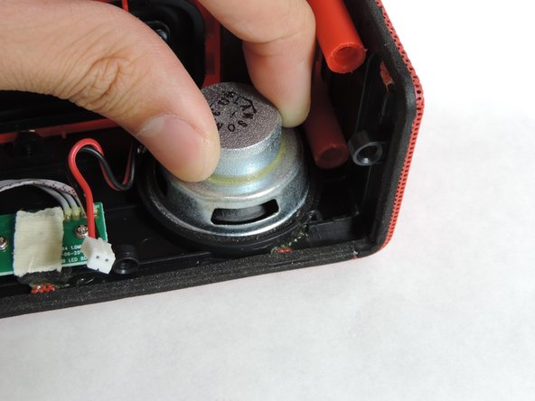

  10. Urge Basics Soundbrick Speaker Woofer Replacement: crwdns2935265:010crwdnd2935265:01crwdnd2935265:03crwdne2935265:0 Urge Basics Soundbrick Speaker Woofer Replacement: crwdns2935265:010crwdnd2935265:02crwdnd2935265:03crwdne2935265:0 Urge Basics Soundbrick Speaker Woofer Replacement: crwdns2935265:010crwdnd2935265:03crwdnd2935265:03crwdne2935265:0
    • Remove the two Phillips #1 screws keeping each woofer in place.
    • Carefully remove the woofers and replace them with new ones.
