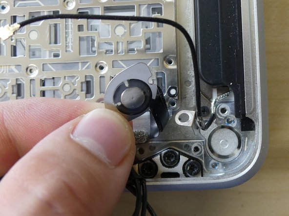

  30. Upgrading your 2.0 GHz 13" Aluminum Unibody MacBook to a Backlit Keyboard: crwdns2935265:030crwdnd2935265:01crwdnd2935265:01crwdne2935265:0
    • De-route the battery connector cable through the gap in the upper case and remove it from the computer.
    • If you are installing an Upper Case that is missing the black bracket in the middle then transfer it from the old case to the replacement.

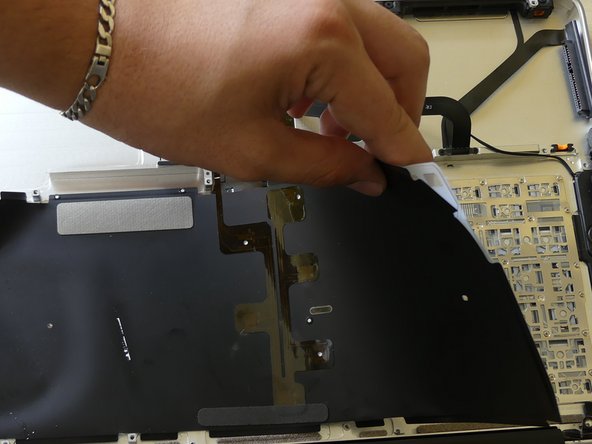

  33. Upgrading your 2.0 GHz 13" Aluminum Unibody MacBook to a Backlit Keyboard: crwdns2935265:033crwdnd2935265:01crwdnd2935265:02crwdne2935265:0 Upgrading your 2.0 GHz 13" Aluminum Unibody MacBook to a Backlit Keyboard: crwdns2935265:033crwdnd2935265:02crwdnd2935265:02crwdne2935265:0

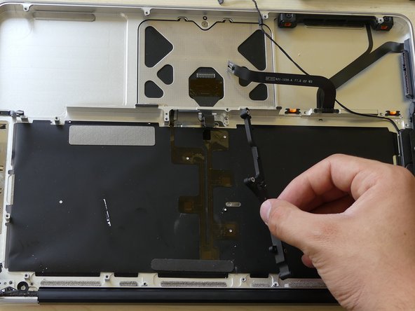

    • First, you'll notice the large black piece of plastic over the back of the keyboard.
    • You will need to use a spudger or a small straight edge screwdriver to carefully unstick the the edges of the plastic from the upper case.
    • Be careful not to tear the plastic as it is very thin.
  34. Upgrading your 2.0 GHz 13" Aluminum Unibody MacBook to a Backlit Keyboard: crwdns2935265:034crwdnd2935265:01crwdnd2935265:01crwdne2935265:0

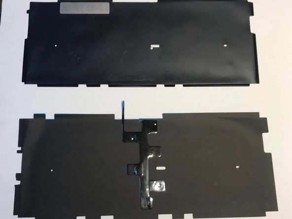

    • Now you will see a large clear plastic wafer stuck to the back of the keyboard.
    • You can remove this easily buy peeling it up slowly.

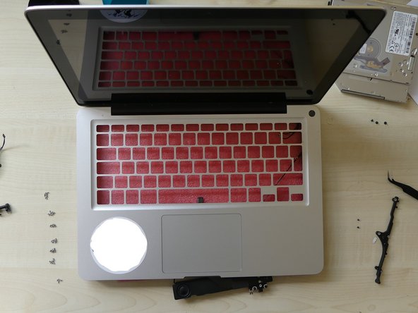

  37. Upgrading your 2.0 GHz 13" Aluminum Unibody MacBook to a Backlit Keyboard: crwdns2935265:037crwdnd2935265:01crwdnd2935265:02crwdne2935265:0 Upgrading your 2.0 GHz 13" Aluminum Unibody MacBook to a Backlit Keyboard: crwdns2935265:037crwdnd2935265:02crwdnd2935265:02crwdne2935265:0
    • Now that you have removed all of the screws, you can gently press on the face side of the keyboard and it will come right out. (If you have removed all the screws.)
    • Here is an image of the top case without its keyboard. I hope you're not winded yet. We're only half way there!

just a question. Where exactly do I put the backlight? Because I have a black film, then a thick plastic sheet, then the metal. then the silicon layer with the components inside, and then the front black sheet, and above that you mount the keys. In between which layer do I put the backlight?
Kevin Zygmunt - crwdns2934203:0crwdne2934203:0
Remove black film and put your backlit

I realize that this guide is getting a bit old, but I bought just the backlight part off Ebay. It's essentially a black film with couple of leds, a clear plastic sheet and a black matte layer. It goes on top (if you look at the MB from the bottom, as in this guide) the metal layer. So it replaces the parts you remove in steps 32 and 33, after which you can start reassembling.
NDE - crwdns2934203:0crwdne2934203:0
