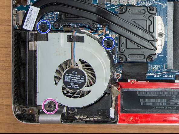

  11. Upgrade the display panel and replace the display cable, Release the fan: crwdns2935265:011crwdnd2935265:01crwdnd2935265:03crwdne2935265:0 Upgrade the display panel and replace the display cable, Release the fan: crwdns2935265:011crwdnd2935265:02crwdnd2935265:03crwdne2935265:0 Upgrade the display panel and replace the display cable, Release the fan: crwdns2935265:011crwdnd2935265:03crwdnd2935265:03crwdne2935265:0
    • Detach the adhesive stripe that secures the webcam's and the display's cable to the fan.

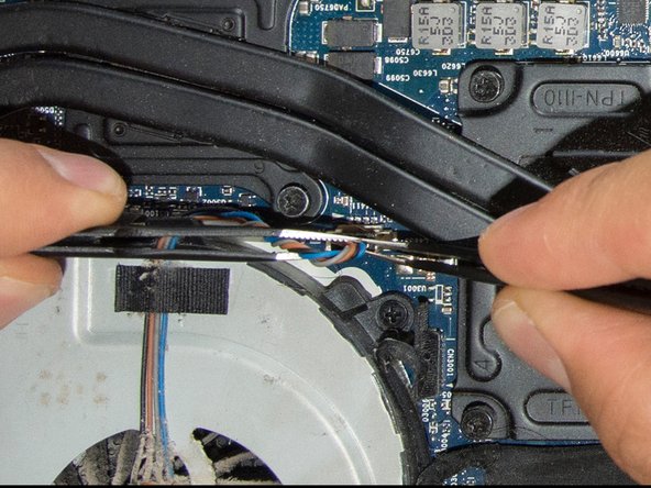

    • Disconnect the fan's ribbon connector. It would be better if you would follow this method (step#2) but if you do not properly manage to grab the connector with your fingers, take two pairs of tweezers, grab all the wires as close as possible to the connector ─ as it is shown in pic#2 ─ and resolutely pull them straight up.
    • Using a PH#00 screwdriver remove the two Phillips PM2.5×4.5 screws and group them together.
    • Using a PH#00 screwdriver remove the last Phillips PM2.5×6.5 screw that secure the fan to the top cover. Do not group it together with the two previous screws because it is longer than those.

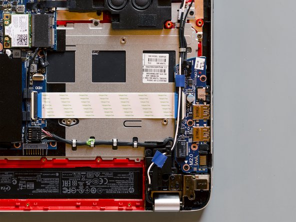

  13. Upgrade the display panel and replace the display cable, Open the ZIF connector that secures the display cable: crwdns2935265:013crwdnd2935265:01crwdnd2935265:03crwdne2935265:0 Upgrade the display panel and replace the display cable, Open the ZIF connector that secures the display cable: crwdns2935265:013crwdnd2935265:02crwdnd2935265:03crwdne2935265:0 Upgrade the display panel and replace the display cable, Open the ZIF connector that secures the display cable: crwdns2935265:013crwdnd2935265:03crwdnd2935265:03crwdne2935265:0
    • Using both, a pair of tweezers and your fingers, detach the adhesive which covers the display's ZIF connector. Be careful not to damage the two thin wires which are also held down by the adhesive.
    • Then, using a spudger, flip up the locking flap of the connector by prying it open. It's possible that it won't disconnect at once because it is quite a firm and long connector. If it is so, don't force it, but gently pry it open to the sides also.
  14. Upgrade the display panel and replace the display cable, Release the display cable from its routing channel: crwdns2935265:014crwdnd2935265:01crwdnd2935265:03crwdne2935265:0 Upgrade the display panel and replace the display cable, Release the display cable from its routing channel: crwdns2935265:014crwdnd2935265:02crwdnd2935265:03crwdne2935265:0 Upgrade the display panel and replace the display cable, Release the display cable from its routing channel: crwdns2935265:014crwdnd2935265:03crwdnd2935265:03crwdne2935265:0
    • Using a pair of tweezers, grab the display cable in the middle and lift it up in order to take it out of the connector.
    • Release now the display cable from its routing channel up to the left hinge. Pull it out using your hands and by getting round the plastic clips.

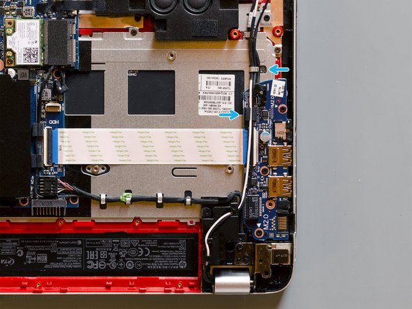

  18. Upgrade the display panel and replace the display cable, Release the wireless antenna cables (1 of 2): crwdns2935265:018crwdnd2935265:01crwdnd2935265:03crwdne2935265:0 Upgrade the display panel and replace the display cable, Release the wireless antenna cables (1 of 2): crwdns2935265:018crwdnd2935265:02crwdnd2935265:03crwdne2935265:0 Upgrade the display panel and replace the display cable, Release the wireless antenna cables (1 of 2): crwdns2935265:018crwdnd2935265:03crwdnd2935265:03crwdne2935265:0
    • Using a pair of tweezers detach the adhesive stripe that holds down the antenna cables on the motherboard.
    • Using your hands ─ and paying attention to clips and intersections with other cables ─ begin to release the wireless antenna cables from their routing channel built between the subwoofer and left front speaker.
  19. Upgrade the display panel and replace the display cable, Release the wireless antenna cables (2 of 2): crwdns2935265:019crwdnd2935265:01crwdnd2935265:03crwdne2935265:0 Upgrade the display panel and replace the display cable, Release the wireless antenna cables (2 of 2): crwdns2935265:019crwdnd2935265:02crwdnd2935265:03crwdne2935265:0 Upgrade the display panel and replace the display cable, Release the wireless antenna cables (2 of 2): crwdns2935265:019crwdnd2935265:03crwdnd2935265:03crwdne2935265:0
    • Carry on the removal of the wireless antenna cables releasing them from eventual intersections with other cables and from the clips built into the top cover and the connector board. Use a spudger to separate them from the other cables if you like.
    • Conclude the removal by releasing the antenna cables from the clips and the routing channel built into the left rear speaker.

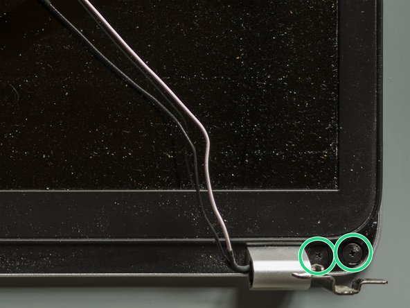

    • Using a PH#00 screwdriver remove the two Phillips PM2.5x4.5 that secure the right hinge to the top cover. You can group these screws together with the one we removed from the left hinge in the step#16: they are identical.

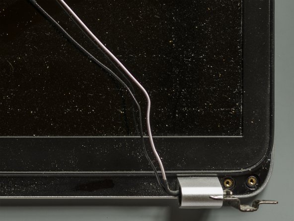

  21. Upgrade the display panel and replace the display cable, Open the right display hinge: crwdns2935265:021crwdnd2935265:01crwdnd2935265:03crwdne2935265:0 Upgrade the display panel and replace the display cable, Open the right display hinge: crwdns2935265:021crwdnd2935265:02crwdnd2935265:03crwdne2935265:0 Upgrade the display panel and replace the display cable, Open the right display hinge: crwdns2935265:021crwdnd2935265:03crwdnd2935265:03crwdne2935265:0
    • Using the small pliers grab the right hinge in the middle and pull it up as far as it opens. Observe the same precautions you followed opening the left display hinge: grab it in the middle only.
    • While the hinge is being pulled, this small centring pin has to come out of it. Keep an eye on it because it can easily break. You could use a metal spudger behind the hinge to hold the plastics down while you're raising the hinge if you like.
    • Be careful. As you can see sliding from pic#2 to pic#3 I broke the plastic which was holding the golden thread of one screw. When I then reassembled the laptop, I had to glue it back in its position. These screws keep the laptop together, if you broke their threads too, put those back together with glue.
    • On another occasion, when I was probably disassembling or mounting the base enclosure, I also broke the thread pointed by the shorter red arrow. I never managed to find all of its plastic broken pieces to rebuilt it in the end, so, watch out!

  39. Upgrade the display panel and replace the display cable, Join the top cover and the display assembly: crwdns2935265:039crwdnd2935265:01crwdnd2935265:03crwdne2935265:0 Upgrade the display panel and replace the display cable, Join the top cover and the display assembly: crwdns2935265:039crwdnd2935265:02crwdnd2935265:03crwdne2935265:0 Upgrade the display panel and replace the display cable, Join the top cover and the display assembly: crwdns2935265:039crwdnd2935265:03crwdnd2935265:03crwdne2935265:0
    • Draw all the wires which come out from the hinges away from the display panel.
    • Retrieve the top cover and place it over the display assembly. First lay its bottom down so that the hinges will help you to centre it properly and afterwards gently turn the top cover down over the display.
  40. Upgrade the display panel and replace the display cable, Lock the display hinges to the top cover: crwdns2935265:040crwdnd2935265:01crwdnd2935265:03crwdne2935265:0 Upgrade the display panel and replace the display cable, Lock the display hinges to the top cover: crwdns2935265:040crwdnd2935265:02crwdnd2935265:03crwdne2935265:0 Upgrade the display panel and replace the display cable, Lock the display hinges to the top cover: crwdns2935265:040crwdnd2935265:03crwdnd2935265:03crwdne2935265:0
    • Using the small pliers grab the hinge in the middle and push it down. Once it is almost fully attached, finish the operation pressing its top with your fingers. If the centring pin manages to pass trough the hinge, top cover and display assembly are correctly aligned.
    • Using a PH#00 screwdriver reassemble two of the three Phillips PM2.5×4.5 screws in order to fasten the right display hinge to the top cover.
    • Repeat the previous two operations on the left hinge. Have a look at step#14 if you don't remember where the remaining Phillips PM2.5×4.5 screw has to be reassembled.
    • Once both of the hinges are fastened, set the left rear speaker in its original position and secure it to the top cover mounting its two screws.
  41. Upgrade the display panel and replace the display cable, Place back the wireless antenna cables (1 of 2): crwdns2935265:041crwdnd2935265:01crwdnd2935265:03crwdne2935265:0 Upgrade the display panel and replace the display cable, Place back the wireless antenna cables (1 of 2): crwdns2935265:041crwdnd2935265:02crwdnd2935265:03crwdne2935265:0 Upgrade the display panel and replace the display cable, Place back the wireless antenna cables (1 of 2): crwdns2935265:041crwdnd2935265:03crwdnd2935265:03crwdne2935265:0
    • Starting from the exit of the right hinge, guide the two wires together along their routing channel. Look out for and make use of all the clips.
    • If you like, add some electrical tape.
  42. Upgrade the display panel and replace the display cable, Place the wireless antenna cables back (2 of 2): crwdns2935265:042crwdnd2935265:01crwdnd2935265:03crwdne2935265:0 Upgrade the display panel and replace the display cable, Place the wireless antenna cables back (2 of 2): crwdns2935265:042crwdnd2935265:02crwdnd2935265:03crwdne2935265:0 Upgrade the display panel and replace the display cable, Place the wireless antenna cables back (2 of 2): crwdns2935265:042crwdnd2935265:03crwdnd2935265:03crwdne2935265:0
    • Go on setting the cables in their channel built between the front speaker and the subwoofer. Use a spudger to push the antenna wires and the other cable with ease inside the two metal clips.
    • Reattach the adhesive stripe which holds the antenna wires tight to the mother board.
    • Once the wifi antenna cables have been correctly routed, connect them back to the wifi & BT module. Place the golden end of each wire over its coaxial connector and, using a spudger, simply press it down straightly and forcefully: they will loudly snap into their connectors. Look at pic#3 in order not to mix up the cables!
  43. Upgrade the display panel and replace the display cable, Reconnect the display cable to the mother board (1 of 2): crwdns2935265:043crwdnd2935265:01crwdnd2935265:03crwdne2935265:0 Upgrade the display panel and replace the display cable, Reconnect the display cable to the mother board (1 of 2): crwdns2935265:043crwdnd2935265:02crwdnd2935265:03crwdne2935265:0 Upgrade the display panel and replace the display cable, Reconnect the display cable to the mother board (1 of 2): crwdns2935265:043crwdnd2935265:03crwdnd2935265:03crwdne2935265:0
    • Starting from the left hinge, guide the display cable to its connector letting it pass though the clips of its routing channel.
    • Then get the connector ready: detach the adhesive tape which is over it and open its flap.
  44. Upgrade the display panel and replace the display cable, Reconnect the display cable to the mother board (2 of 2): crwdns2935265:044crwdnd2935265:01crwdnd2935265:03crwdne2935265:0 Upgrade the display panel and replace the display cable, Reconnect the display cable to the mother board (2 of 2): crwdns2935265:044crwdnd2935265:02crwdnd2935265:03crwdne2935265:0 Upgrade the display panel and replace the display cable, Reconnect the display cable to the mother board (2 of 2): crwdns2935265:044crwdnd2935265:03crwdnd2935265:03crwdne2935265:0
    • Lay the display cable's end inside the connector. It is rightly positioned when its two indentations match the two small black "squares" at the edges of the ZIF connector and when the white line visually creates a single line with the those "squares".
    • Then, keeping the cable positioned with one hand, push the locking flap down using a spudger. This operation has not to be done in one single movement: start pressing the middle of the flap and evenly proceed with its edges.
    • Once the flap of the connector is locked, reattach the adhesive tape over the connector. Mind the other two wires which it is also holding.
  45. Upgrade the display panel and replace the display cable, Reconnect the webcam cable: crwdns2935265:045crwdnd2935265:01crwdnd2935265:02crwdne2935265:0 Upgrade the display panel and replace the display cable, Reconnect the webcam cable: crwdns2935265:045crwdnd2935265:02crwdnd2935265:02crwdne2935265:0
    • Place the webcam cable back in its routing channel, laying it over the display cable and letting it go through the same clips.
    • When the webcam cable meets the adhesive stripe of the display cable, let the former go behind the latter so that later, once you will be attaching this adhesive stripe over the fan, it will hold also the webcam cable in position.
    • Once the webcam cable is correctly positioned, grab its end as shown in pic#2 and push it inside its ribbon connector resolutely, with one single movement.
