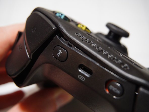

    • When your triggers get stickier than the Cheeto® dust on your hands it might be time for an intervention.
  2. Unsticking SteelSeries Nimbus Triggers: crwdns2935265:02crwdnd2935265:01crwdnd2935265:02crwdne2935265:0 Unsticking SteelSeries Nimbus Triggers: crwdns2935265:02crwdnd2935265:02crwdnd2935265:02crwdne2935265:0

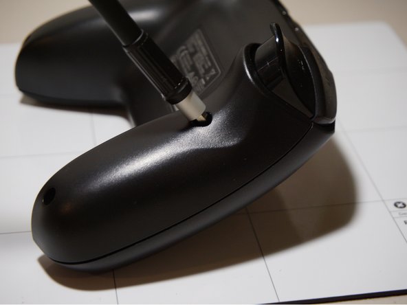

    • Start off by removing the four TR9 Torx Security screws on the back of the controller.
  3. Unsticking SteelSeries Nimbus Triggers: crwdns2935265:03crwdnd2935265:01crwdnd2935265:03crwdne2935265:0 Unsticking SteelSeries Nimbus Triggers: crwdns2935265:03crwdnd2935265:02crwdnd2935265:03crwdne2935265:0 Unsticking SteelSeries Nimbus Triggers: crwdns2935265:03crwdnd2935265:03crwdnd2935265:03crwdne2935265:0

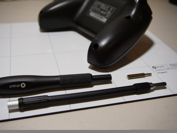

    • The two screws on the top are further inset than the others. You can use the iFixit 1/4" to 4 mm Driver Adapter as an extender.
  4. Unsticking SteelSeries Nimbus Triggers: crwdns2935265:04crwdnd2935265:01crwdnd2935265:02crwdne2935265:0 Unsticking SteelSeries Nimbus Triggers: crwdns2935265:04crwdnd2935265:02crwdnd2935265:02crwdne2935265:0

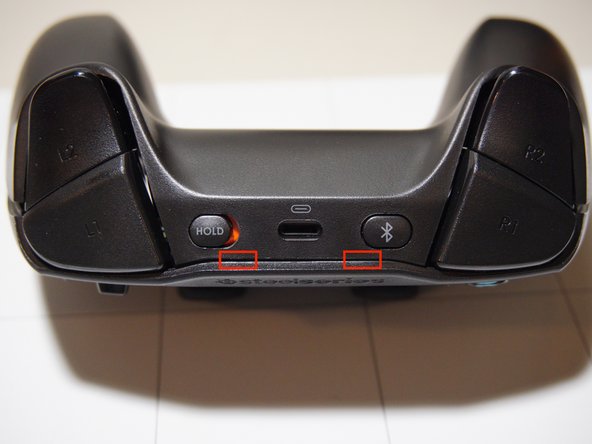

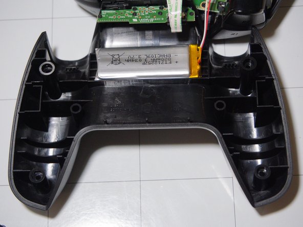

    • The case is now open, but it's still held together by two clips on the top.
  5. Unsticking SteelSeries Nimbus Triggers: crwdns2935265:05crwdnd2935265:01crwdnd2935265:03crwdne2935265:0 Unsticking SteelSeries Nimbus Triggers: crwdns2935265:05crwdnd2935265:02crwdnd2935265:03crwdne2935265:0 Unsticking SteelSeries Nimbus Triggers: crwdns2935265:05crwdnd2935265:03crwdnd2935265:03crwdne2935265:0
    • Apply a gentle twisting motion to separate the first clip.
    • Twist in the other direction to separate the second clip.

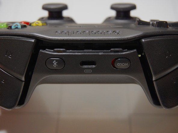

    • The top is now free!
  6. Unsticking SteelSeries Nimbus Triggers: crwdns2935265:06crwdnd2935265:01crwdnd2935265:03crwdne2935265:0 Unsticking SteelSeries Nimbus Triggers: crwdns2935265:06crwdnd2935265:02crwdnd2935265:03crwdne2935265:0 Unsticking SteelSeries Nimbus Triggers: crwdns2935265:06crwdnd2935265:03crwdnd2935265:03crwdne2935265:0

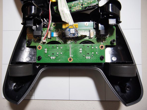

    • Be mindful of the three cables still connecting the two halves.
  7. Unsticking SteelSeries Nimbus Triggers: crwdns2935265:07crwdnd2935265:01crwdnd2935265:02crwdne2935265:0 Unsticking SteelSeries Nimbus Triggers: crwdns2935265:07crwdnd2935265:02crwdnd2935265:02crwdne2935265:0

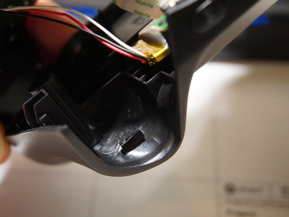

    • Here's our problem, the rubber pad has fallen off of the plastic stop leaving only the glue behind.
    • The rubber pad should still be in the controller somewhere (happy hunting) or if you're not in the mood for hide and seek any kind of foam will work as a replacement.
