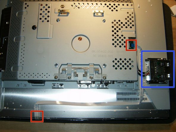

    • Here is the ribbon cable from the button bar. Just unsnap the front bezel, but do not remove it.
    • Once the front bezel is completely unsnapped, but not removed, turn the monitor over.

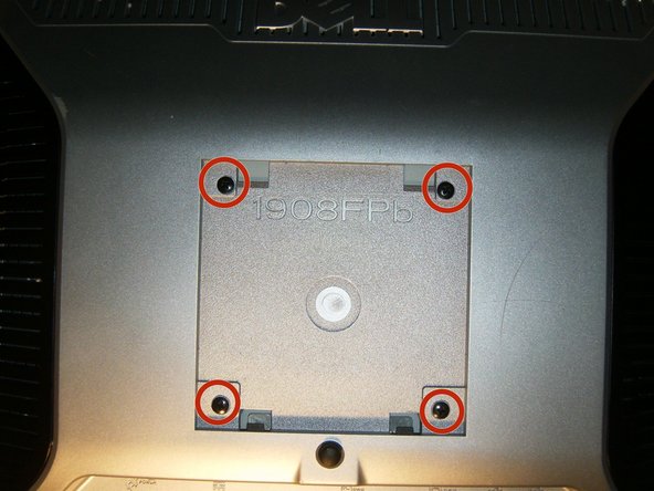

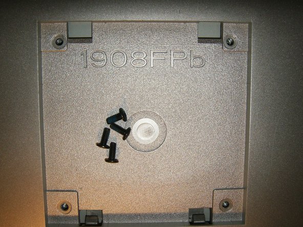

    • Remove the four Phillips screws from the VESA mount.
    • The four screws are M4x10mm
  4. Universal Backlight Inverter: crwdns2935265:04crwdnd2935265:01crwdnd2935265:03crwdne2935265:0 Universal Backlight Inverter: crwdns2935265:04crwdnd2935265:02crwdnd2935265:03crwdne2935265:0 Universal Backlight Inverter: crwdns2935265:04crwdnd2935265:03crwdnd2935265:03crwdne2935265:0
    • With the four screws removed and the front bezel snapped off, the back cover simply pulls off.
    • Here is the ribbon cable coming from the front button bar, the way it is routed and where it connects.
    • this monitor has an additional 2 USB ports
    • The ribbon cable connector needs to be flipped open to remove the cable. Flip the black tab from left to right to open it
  5. Universal Backlight Inverter: crwdns2935265:05crwdnd2935265:01crwdnd2935265:03crwdne2935265:0 Universal Backlight Inverter: crwdns2935265:05crwdnd2935265:02crwdnd2935265:03crwdne2935265:0 Universal Backlight Inverter: crwdns2935265:05crwdnd2935265:03crwdnd2935265:03crwdne2935265:0
    • With the ribbon cable disconnected, remove the front bezel.
    • The additional USB ports use a push connector.
    • Remove it by pulling on the Molex connector, not the cables.

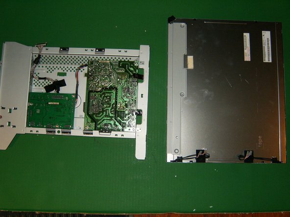

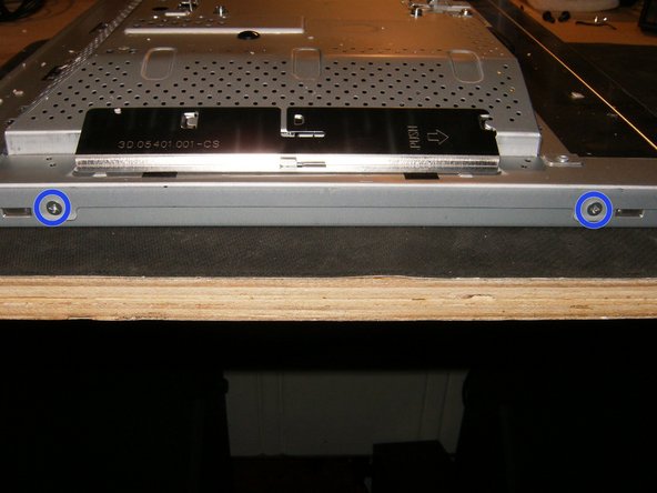

    • Remove the two Phillips screws on the right
    • then the two on the left.

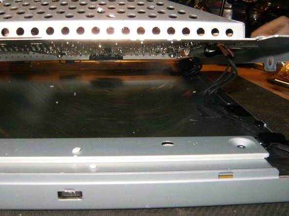

    • Do not remove the back panel yet, just gently lift it to reveal the LVDS cable
  7. Universal Backlight Inverter: crwdns2935265:07crwdnd2935265:01crwdnd2935265:03crwdne2935265:0 Universal Backlight Inverter: crwdns2935265:07crwdnd2935265:02crwdnd2935265:03crwdne2935265:0 Universal Backlight Inverter: crwdns2935265:07crwdnd2935265:03crwdnd2935265:03crwdne2935265:0
    • Here is the LVDS connector.
    • Slide the cover up the panel a bit to get good access to the connector
    • Remove the LVDS cable by squeezing the ends inward
  8. Universal Backlight Inverter: crwdns2935265:08crwdnd2935265:01crwdnd2935265:03crwdne2935265:0 Universal Backlight Inverter: crwdns2935265:08crwdnd2935265:02crwdnd2935265:03crwdne2935265:0 Universal Backlight Inverter: crwdns2935265:08crwdnd2935265:03crwdnd2935265:03crwdne2935265:0

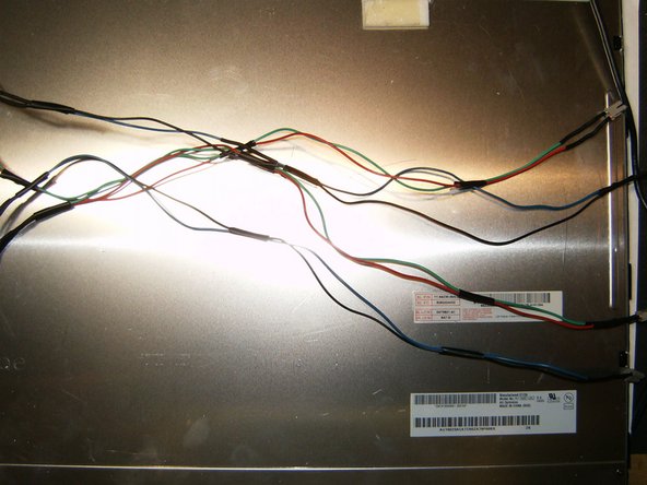

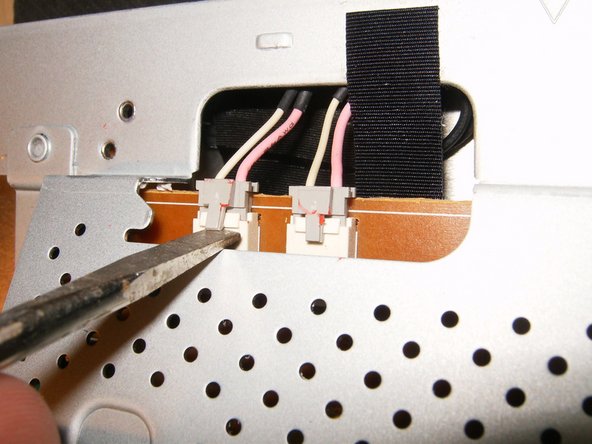

    • This monitor had a cover over the CCFL connectors. Remove it by simply sliding it in the direction of the arrow that is marked on it.
    • Here are the four connectors for the CCFL's.
    • Remove the connectors by lifting the locking tab. This can be done with good fingernails or a small screwdriver, and then pull the connectors apart.
  9. Universal Backlight Inverter: crwdns2935265:09crwdnd2935265:01crwdnd2935265:03crwdne2935265:0 Universal Backlight Inverter: crwdns2935265:09crwdnd2935265:02crwdnd2935265:03crwdne2935265:0 Universal Backlight Inverter: crwdns2935265:09crwdnd2935265:03crwdnd2935265:03crwdne2935265:0
    • All CCFL connectors removed. The position on the CCFL connectors is irrelevant. They will only fit one way into the connection.
    • With the CCFL's disconnected separate the back case from the LCD
    • The panel has two connectors on the top right, and two connectors on the bottom right.

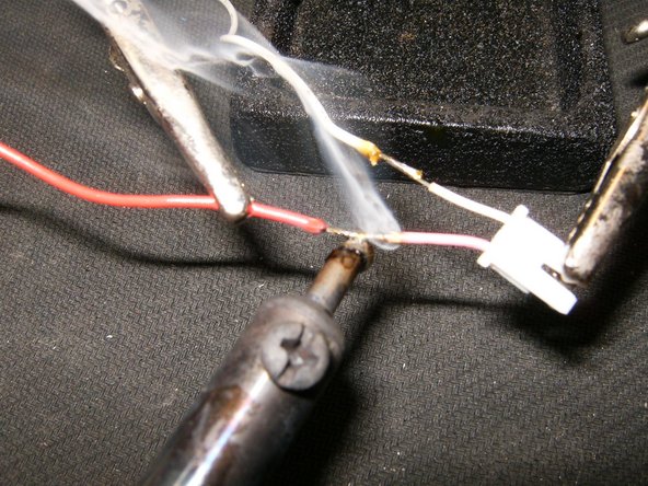

    • Destruction! Simply use a pair of scissors, or any other cutting instrument, and cut the connectors. Leave about 1/2 inch to 3/4 inch of the cable on the connector.
    • Remove the insulation from the cut ends.
    • Use 2 28AWG wires. The length on these is about 12inches. Remove the insulation from all the ends.
  11. Universal Backlight Inverter: crwdns2935265:011crwdnd2935265:01crwdnd2935265:03crwdne2935265:0 Universal Backlight Inverter: crwdns2935265:011crwdnd2935265:02crwdnd2935265:03crwdne2935265:0 Universal Backlight Inverter: crwdns2935265:011crwdnd2935265:03crwdnd2935265:03crwdne2935265:0
    • Time for some soldering. It could also be accomplished with some other wire connectors, but I prefer to solder.
    • Butt end the wires, use flux and solder the wires together.
    • I had a few pieces of shrink tubing left over from other projects, electric tape can also be used,
  12. Universal Backlight Inverter: crwdns2935265:012crwdnd2935265:01crwdnd2935265:03crwdne2935265:0 Universal Backlight Inverter: crwdns2935265:012crwdnd2935265:02crwdnd2935265:03crwdne2935265:0 Universal Backlight Inverter: crwdns2935265:012crwdnd2935265:03crwdnd2935265:03crwdne2935265:0
    • to slide over the wire connection, to provide insulation.
    • Continue to solder
    • until all four connectors are extended.
    • Do the same with the connectors. Make sure that you follow the proper wires to connect pink/pink and white/white

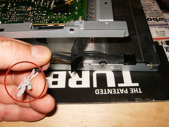

    • Place the inverter with the Velcro in the case. Once placed properly, insert the four backlight connector into the inverter.
    • The monitor is now ready for reassembly. Fish the four wires from the inverter through an opening in the case.
  16. Universal Backlight Inverter: crwdns2935265:016crwdnd2935265:01crwdnd2935265:03crwdne2935265:0 Universal Backlight Inverter: crwdns2935265:016crwdnd2935265:02crwdnd2935265:03crwdne2935265:0 Universal Backlight Inverter: crwdns2935265:016crwdnd2935265:03crwdnd2935265:03crwdne2935265:0
    • Once more, the four wires from the inverter need to be fished through am opening in the back
    • Okay, now it's test time. Combine the Yellow On/Off wire with the Black Vin Wire. That will be the positive connection, the Red wire is ground and will be the negative. This inverter is rated 12-24Volt, so an old laptop power brick will be perfect.

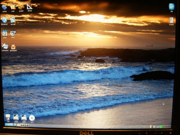

    • Data line connected to a computer and power to the inverter shows a great image. The only issue with this right now is that the power to the monitor and the backlight are separate. I did not find a suitable power source on the original power board. Also, the brightness can not be adjusted with this hook up.
