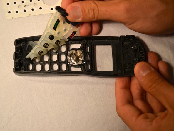

    1. Uniden TCX905 Home Button Replacement, Home Button: crwdns2935265:08crwdnd2935265:01crwdnd2935265:03crwdne2935265:0 Uniden TCX905 Home Button Replacement, Home Button: crwdns2935265:08crwdnd2935265:02crwdnd2935265:03crwdne2935265:0 Uniden TCX905 Home Button Replacement, Home Button: crwdns2935265:08crwdnd2935265:03crwdnd2935265:03crwdne2935265:0
      • Remove the white plastic sheet covering the silicon button pad
      • Remove the silicon button pad to access the home button and spring
      • Note: Be mindful that the spring is small and sensitive and can be lost easily if not cautious

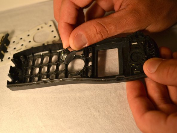

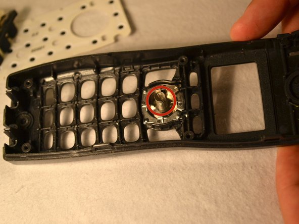

    2. Uniden TCX905 Home Button Replacement: crwdns2935265:09crwdnd2935265:01crwdnd2935265:02crwdne2935265:0 Uniden TCX905 Home Button Replacement: crwdns2935265:09crwdnd2935265:02crwdnd2935265:02crwdne2935265:0
      • Once the silicon button pad is removed, remove the spring from home button
      • Finally, remove the home button from its setting in the front shell of the phone
