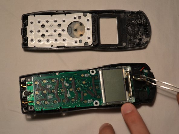

  4. Uniden TCX905 Earpiece Speaker Replacement: crwdns2935265:04crwdnd2935265:01crwdnd2935265:03crwdne2935265:0 Uniden TCX905 Earpiece Speaker Replacement: crwdns2935265:04crwdnd2935265:02crwdnd2935265:03crwdne2935265:0 Uniden TCX905 Earpiece Speaker Replacement: crwdns2935265:04crwdnd2935265:03crwdnd2935265:03crwdne2935265:0
    • Gently open phone casing along the seam at the bottom of the phone using index and middle fingers of both hands
  5. Uniden TCX905 Earpiece Speaker Replacement: crwdns2935265:05crwdnd2935265:01crwdnd2935265:03crwdne2935265:0 Uniden TCX905 Earpiece Speaker Replacement: crwdns2935265:05crwdnd2935265:02crwdnd2935265:03crwdne2935265:0 Uniden TCX905 Earpiece Speaker Replacement: crwdns2935265:05crwdnd2935265:03crwdnd2935265:03crwdne2935265:0
    • Ensure that wired connection between circuit board and back shell is not strained
    • Fold the back shell underneath the front shell and circuit board

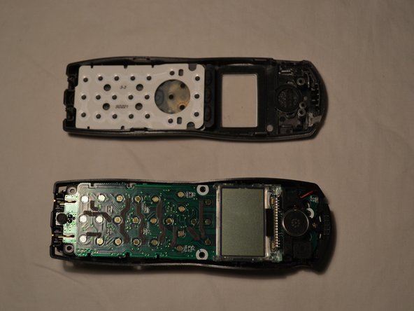

  6. Uniden TCX905 Earpiece Speaker Replacement, Circuit Board: crwdns2935265:06crwdnd2935265:01crwdnd2935265:02crwdne2935265:0 Uniden TCX905 Earpiece Speaker Replacement, Circuit Board: crwdns2935265:06crwdnd2935265:02crwdnd2935265:02crwdne2935265:0
    • Carefully remove the middle two 7mm screws, the outer top 9mm screws, and the top middle 7 mm screw that hold the logic board to the front shell of the phone casing using the Phillips #1 screwdriver
  7. Uniden TCX905 Earpiece Speaker Replacement: crwdns2935265:07crwdnd2935265:01crwdnd2935265:03crwdne2935265:0 Uniden TCX905 Earpiece Speaker Replacement: crwdns2935265:07crwdnd2935265:02crwdnd2935265:03crwdne2935265:0 Uniden TCX905 Earpiece Speaker Replacement: crwdns2935265:07crwdnd2935265:03crwdnd2935265:03crwdne2935265:0
    • Using index finger and thumb, carefully remove the circuit board from the front shell of phone

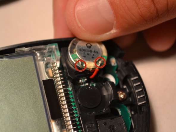

  8. Uniden TCX905 Earpiece Speaker Replacement, Earpiece Speaker: crwdns2935265:08crwdnd2935265:01crwdnd2935265:02crwdne2935265:0 Uniden TCX905 Earpiece Speaker Replacement, Earpiece Speaker: crwdns2935265:08crwdnd2935265:02crwdnd2935265:02crwdne2935265:0
    • Place circuit board gently on the back shell with the earpiece facing up
  9. Uniden TCX905 Earpiece Speaker Replacement: crwdns2935265:09crwdnd2935265:01crwdnd2935265:03crwdne2935265:0 Uniden TCX905 Earpiece Speaker Replacement: crwdns2935265:09crwdnd2935265:02crwdnd2935265:03crwdne2935265:0 Uniden TCX905 Earpiece Speaker Replacement: crwdns2935265:09crwdnd2935265:03crwdnd2935265:03crwdne2935265:0
    • Pry speaker gently from setting using tweezers
    • Cut red and black wires near the soldering
