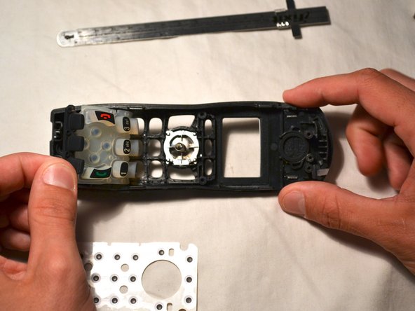

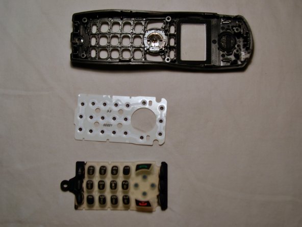

    1. Uniden TCX905 Button Keypad Cleaning Guide, Button Keypad: crwdns2935265:08crwdnd2935265:01crwdnd2935265:03crwdne2935265:0 Uniden TCX905 Button Keypad Cleaning Guide, Button Keypad: crwdns2935265:08crwdnd2935265:02crwdnd2935265:03crwdne2935265:0 Uniden TCX905 Button Keypad Cleaning Guide, Button Keypad: crwdns2935265:08crwdnd2935265:03crwdnd2935265:03crwdne2935265:0
      • Remove the white plastic sheet covering the button pad with your fingers
      • Gently remove the silicon button pad

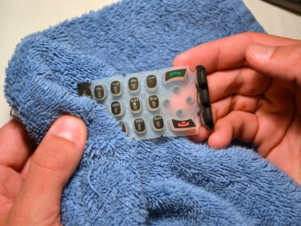

    2. Uniden TCX905 Button Keypad Cleaning Guide: crwdns2935265:09crwdnd2935265:01crwdnd2935265:02crwdne2935265:0 Uniden TCX905 Button Keypad Cleaning Guide: crwdns2935265:09crwdnd2935265:02crwdnd2935265:02crwdne2935265:0
      • Wet one end of the cotton swab with water and clean button pad as needed
      • Repeat process with multiple cotton swabs if needed
      • Dry the button pad with a clean, soft rag before replacing
