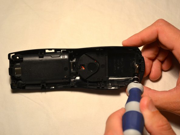

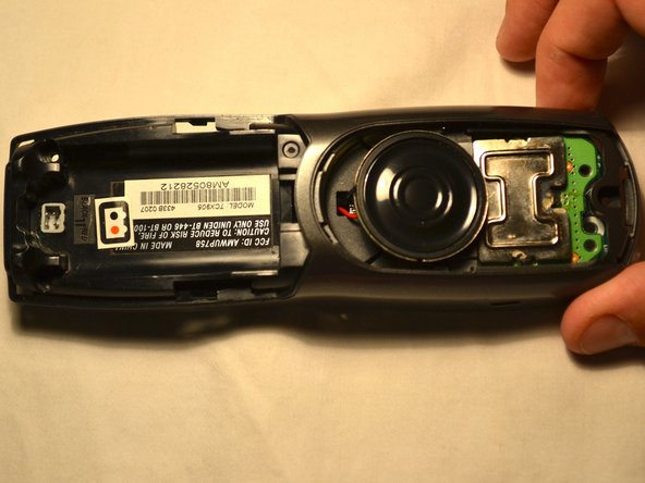

  6. Uniden TCX905 Back Speaker Replacement, Back Speaker: crwdns2935265:06crwdnd2935265:01crwdnd2935265:02crwdne2935265:0 Uniden TCX905 Back Speaker Replacement, Back Speaker: crwdns2935265:06crwdnd2935265:02crwdnd2935265:02crwdne2935265:0
    • Lay the back shell with the inside facing up
    • To remove the speaker guard, first remove the 7mm screw from inside the back shell

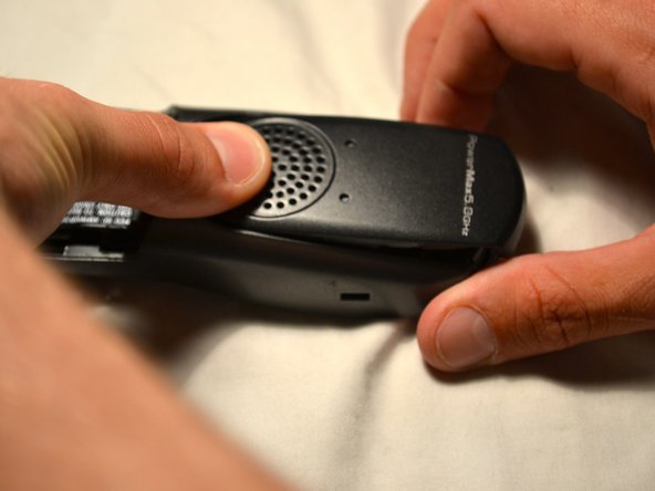

  7. Uniden TCX905 Back Speaker Replacement: crwdns2935265:07crwdnd2935265:01crwdnd2935265:03crwdne2935265:0 Uniden TCX905 Back Speaker Replacement: crwdns2935265:07crwdnd2935265:02crwdnd2935265:03crwdne2935265:0 Uniden TCX905 Back Speaker Replacement: crwdns2935265:07crwdnd2935265:03crwdnd2935265:03crwdne2935265:0
    • To access the speaker, flip the back shell over and use a plastic opening tool to pop open the black cover
    • Gently push the speaker guard out of place with your thumb
    • Carefully slide the speaker out from its setting and place speaker guard aside

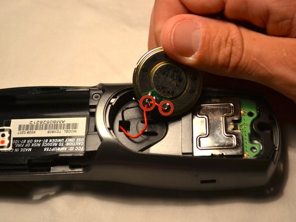

  8. Uniden TCX905 Back Speaker Replacement: crwdns2935265:08crwdnd2935265:01crwdnd2935265:02crwdne2935265:0 Uniden TCX905 Back Speaker Replacement: crwdns2935265:08crwdnd2935265:02crwdnd2935265:02crwdne2935265:0
    • With speaker exposed, remove the speaker by cutting the red and black wires near their contact location
