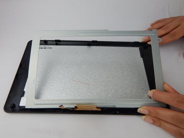

    • Use a J1 Phillips screwdriver to remove the four 6.1 mm screws at the back of the monitor.
  2. Uniden Guardian G955 Touchscreen Replacement: crwdns2935265:02crwdnd2935265:01crwdnd2935265:01crwdne2935265:0
    • Use metal spudger or an opening tool to pry open the device.
  3. Uniden Guardian G955 Touchscreen Replacement: crwdns2935265:03crwdnd2935265:01crwdnd2935265:02crwdne2935265:0 Uniden Guardian G955 Touchscreen Replacement: crwdns2935265:03crwdnd2935265:02crwdnd2935265:02crwdne2935265:0
    • In both pictures, disconnect the zero insertion force (ZIF) connector from the motherboard using your fingernail by sliding up on the male end of the connector to loosen it.
  4. Uniden Guardian G955 Touchscreen Replacement: crwdns2935265:04crwdnd2935265:01crwdnd2935265:01crwdne2935265:0
    • Use a J1 Phillips screwdriver to remove the two 6.1 mm screws.
  5. Uniden Guardian G955 Touchscreen Replacement: crwdns2935265:05crwdnd2935265:01crwdnd2935265:02crwdne2935265:0 Uniden Guardian G955 Touchscreen Replacement: crwdns2935265:05crwdnd2935265:02crwdnd2935265:02crwdne2935265:0
    • Apply pressure to metal casing and slide off.
  6. Uniden Guardian G955 Touchscreen Replacement: crwdns2935265:06crwdnd2935265:01crwdnd2935265:02crwdne2935265:0 Uniden Guardian G955 Touchscreen Replacement: crwdns2935265:06crwdnd2935265:02crwdnd2935265:02crwdne2935265:0
    • Push touchscreen through black case.
