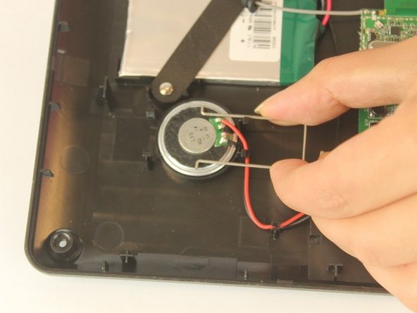

    • Locate the circular speaker in one of the corners of the device. To release the speaker, pinch the metal fastener together and lift it off of the speaker.

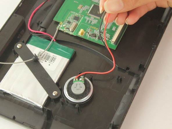

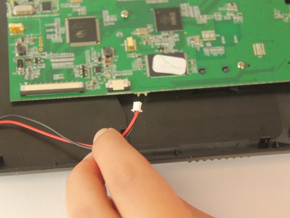

    • Follow the speaker towards the input on the motherboard. Pull it from the motherboard horizontally for it to loosen easier.
    • You may have to wiggle the head of the wire to efficiently remove it from the motherboard.

    • Carefully lift the speaker and all of the components in the speaker socket off of the monitor.
    • The speaker's film may be glued down to the socket where it's held. If this is the case, you must pull it all off and carefully clean it so that you may add the new speaker and ensure it fits with no leftover glue residue from the previous speaker.
