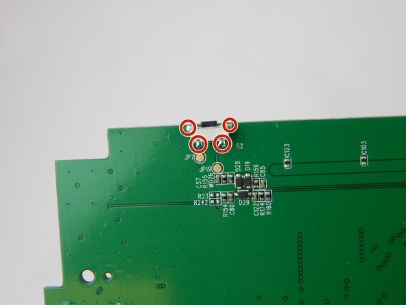

    • Use a J1 Phillips screwdriver to remove the three 6.1 mm screws on the motherboard.
  4. Uniden Guardian G955 Power Button Replacement: crwdns2935265:04crwdnd2935265:01crwdnd2935265:03crwdne2935265:0 Uniden Guardian G955 Power Button Replacement: crwdns2935265:04crwdnd2935265:02crwdnd2935265:03crwdne2935265:0 Uniden Guardian G955 Power Button Replacement: crwdns2935265:04crwdnd2935265:03crwdnd2935265:03crwdne2935265:0

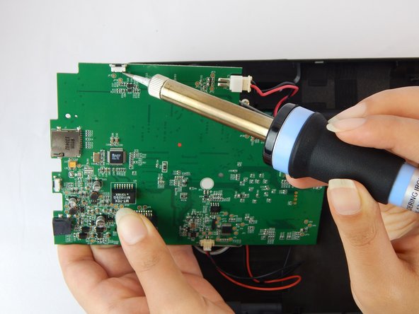

    • Carefully, lift the motherboard and turn it to the backside.
    • Desolder the four corners of the power button. Please follow this link on how to proceed to desolder: How To Solder and Desolder Connections
