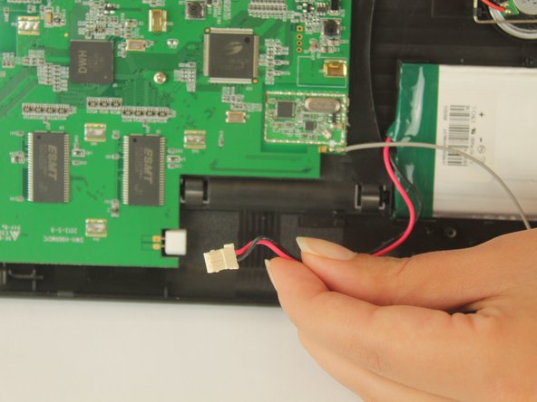

  4. Uniden Guardian G955 Battery  Replacement: crwdns2935265:04crwdnd2935265:01crwdnd2935265:02crwdne2935265:0 Uniden Guardian G955 Battery  Replacement: crwdns2935265:04crwdnd2935265:02crwdnd2935265:02crwdne2935265:0
    • Disconnect the head of the cable attached to the motherboard by pressing on the outer edge of the cable and sliding it out.
  5. Uniden Guardian G955 Battery  Replacement: crwdns2935265:05crwdnd2935265:01crwdnd2935265:02crwdne2935265:0 Uniden Guardian G955 Battery  Replacement: crwdns2935265:05crwdnd2935265:02crwdnd2935265:02crwdne2935265:0

    • Remove the battery from the case by sliding a halberd spudger below it. (note: the spudger shown is metal, to ensure proper safety, utilize a nylon or plastic spudger.)
