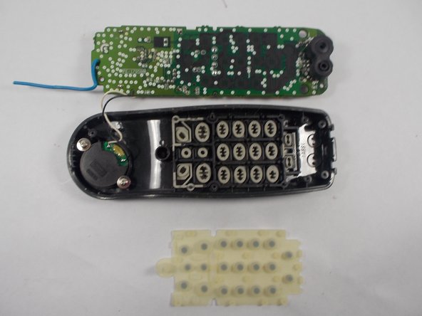

    • Refer to the Uniden EXP 371 phone disassembly guide to open the plastic casing.
  2. Uniden EXP 371 Keypad Replacement: crwdns2935265:02crwdnd2935265:01crwdnd2935265:03crwdne2935265:0 Uniden EXP 371 Keypad Replacement: crwdns2935265:02crwdnd2935265:02crwdnd2935265:03crwdne2935265:0 Uniden EXP 371 Keypad Replacement: crwdns2935265:02crwdnd2935265:03crwdnd2935265:03crwdne2935265:0
    • Use the Phillips #1 screwdriver to unscrew the screws located at the bottom left and right hand corners and top of the phone; as shown in the image.
  3. Uniden EXP 371 Keypad Replacement: crwdns2935265:03crwdnd2935265:01crwdnd2935265:02crwdne2935265:0 Uniden EXP 371 Keypad Replacement: crwdns2935265:03crwdnd2935265:02crwdnd2935265:02crwdne2935265:0
    • Remove the motherboard once the screws holding it in place are undone.
    • Once the motherboard has been removed, remove the rubber button pad located behind the motherboard and in front of the dial pad.
  4. Uniden EXP 371 Keypad Replacement: crwdns2935265:04crwdnd2935265:01crwdnd2935265:01crwdne2935265:0

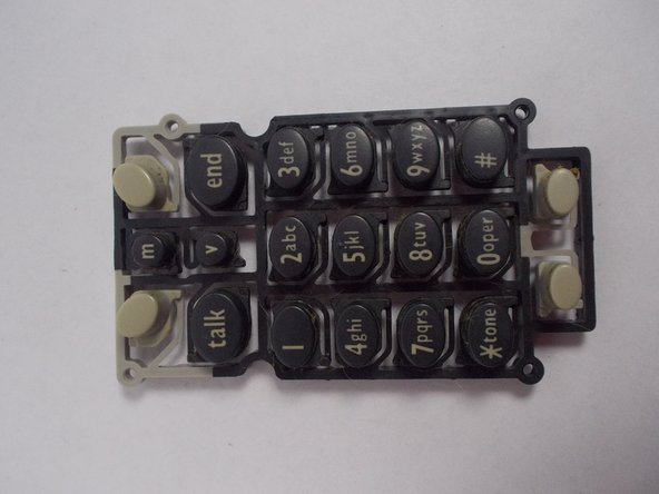

    • After the rubber pad is removed remove the dial pad (buttons) from the phone.
  5. Uniden EXP 371 Keypad Replacement, [OPTIONAL ] Soak dial pad in mixture of soap and water: crwdns2935265:05crwdnd2935265:01crwdnd2935265:02crwdne2935265:0 Uniden EXP 371 Keypad Replacement, [OPTIONAL ] Soak dial pad in mixture of soap and water: crwdns2935265:05crwdnd2935265:02crwdnd2935265:02crwdne2935265:0
    • If the buttons are sticky; leaving the dial pad and/or rubber pad to soak in soap and water for 5-10 minutes will clean off any sticky residue that may be obstructing the buttons.
    • Make sure to properly dry the dial pad and rubber pad of any soap/water before reattaching them to the phone to avoid the risk of short circuiting.
