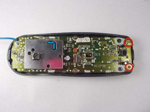

  4. Uniden EXP 371 Charging Contact Points Replacement: crwdns2935265:04crwdnd2935265:01crwdnd2935265:02crwdne2935265:0 Uniden EXP 371 Charging Contact Points Replacement: crwdns2935265:04crwdnd2935265:02crwdnd2935265:02crwdne2935265:0
    • After removing the rear cover there will be two more screws to remove that hold each of the charging contact points. Once those are removed you can replace them with the new ones.
    • When replacing the charging contacts, they only go on one way, but it is useful to note how the original ones were on.
    • Reverse these steps in order to reassemble your phone.
