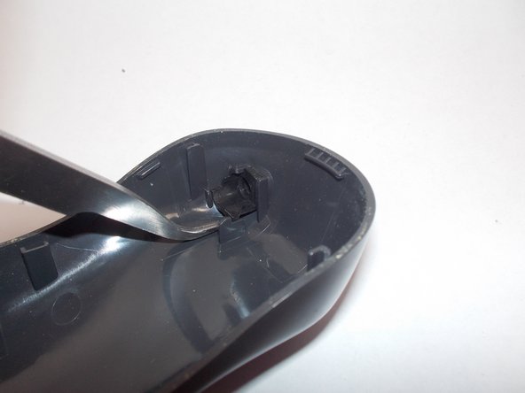

  5. Uniden EXP 371 Antenna Replacement, Antenna: crwdns2935265:05crwdnd2935265:01crwdnd2935265:02crwdne2935265:0 Uniden EXP 371 Antenna Replacement, Antenna: crwdns2935265:05crwdnd2935265:02crwdnd2935265:02crwdne2935265:0
    • After following the teardown guide. Take the bottom case and locate the antenna at the top of the phone.
    • Lift the bottom of the the antenna with the aid of a tool (these tweezers work well) and push the antenna inside the phone to remove it.
    • To reassemble the phone, follow the steps in the reverse order.
