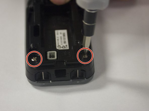

  5. Uniden D1685 front panel and keypad replacement: crwdns2935265:05crwdnd2935265:01crwdnd2935265:02crwdne2935265:0 Uniden D1685 front panel and keypad replacement: crwdns2935265:05crwdnd2935265:02crwdnd2935265:02crwdne2935265:0
    • Remove the two 3.175 mm screws with the small Phillips head (PH1) screwdriver on the bottom of the phone next to where the battery was removed.

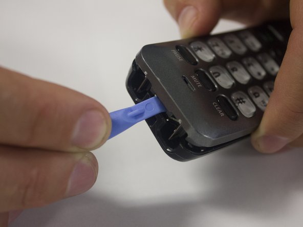

  6. Uniden D1685 front panel and keypad replacement: crwdns2935265:06crwdnd2935265:01crwdnd2935265:02crwdne2935265:0 Uniden D1685 front panel and keypad replacement: crwdns2935265:06crwdnd2935265:02crwdnd2935265:02crwdne2935265:0
    • Once removed, use plastic opening tool to pull the back and front apart in 3 different locations; the bottom and both sides.

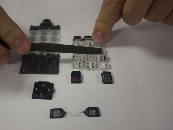

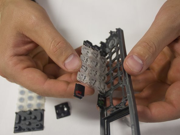

    • The keyboard will now be accessible. Remove the Bumper Pad (rubber pad behind actual keypad).
    • Remove the keypad.
  11. Uniden D1685 front panel and keypad replacement: crwdns2935265:011crwdnd2935265:01crwdnd2935265:02crwdne2935265:0 Uniden D1685 front panel and keypad replacement: crwdns2935265:011crwdnd2935265:02crwdnd2935265:02crwdne2935265:0
    • Clean the pad with cleaning spray and/or a brush.
  12. Uniden D1685 front panel and keypad replacement: crwdns2935265:012crwdnd2935265:01crwdnd2935265:01crwdne2935265:0
    • Once cleaned, make sure to dry off all of the components entirely.
