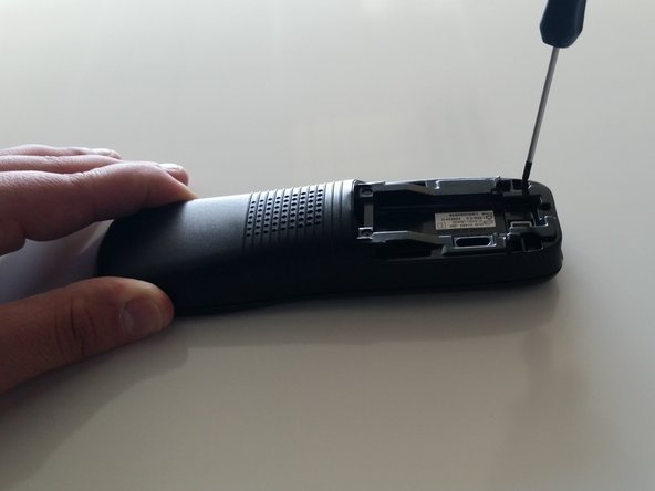

  4. Uniden D1483-3BK Circuit Board/Screen Replacement, Handset Case: crwdns2935265:04crwdnd2935265:01crwdnd2935265:02crwdne2935265:0 Uniden D1483-3BK Circuit Board/Screen Replacement, Handset Case: crwdns2935265:04crwdnd2935265:02crwdnd2935265:02crwdne2935265:0
    • Remove the two 9mm Phillips #1 screws in the battery compartment.

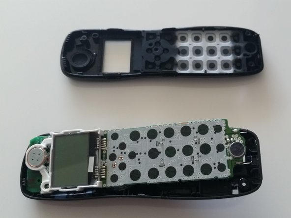

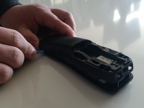

  5. Uniden D1483-3BK Circuit Board/Screen Replacement: crwdns2935265:05crwdnd2935265:01crwdnd2935265:03crwdne2935265:0 Uniden D1483-3BK Circuit Board/Screen Replacement: crwdns2935265:05crwdnd2935265:02crwdnd2935265:03crwdne2935265:0 Uniden D1483-3BK Circuit Board/Screen Replacement: crwdns2935265:05crwdnd2935265:03crwdnd2935265:03crwdne2935265:0
    • Use the plastic opening tool to carefully separate the two halves of the case.
    • Slowly work around the entire case to fully separate the halves before pulling them apart.
    • Wires inside the case hold the two halves together, tearing these wires will lead to a need for additional repair.

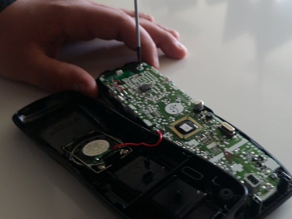

  6. Uniden D1483-3BK Circuit Board/Screen Replacement: crwdns2935265:06crwdnd2935265:01crwdnd2935265:02crwdne2935265:0 Uniden D1483-3BK Circuit Board/Screen Replacement: crwdns2935265:06crwdnd2935265:02crwdnd2935265:02crwdne2935265:0
    • Carefully remove the 9mm Phillips #1 screw from the top corner of the circuit board.
