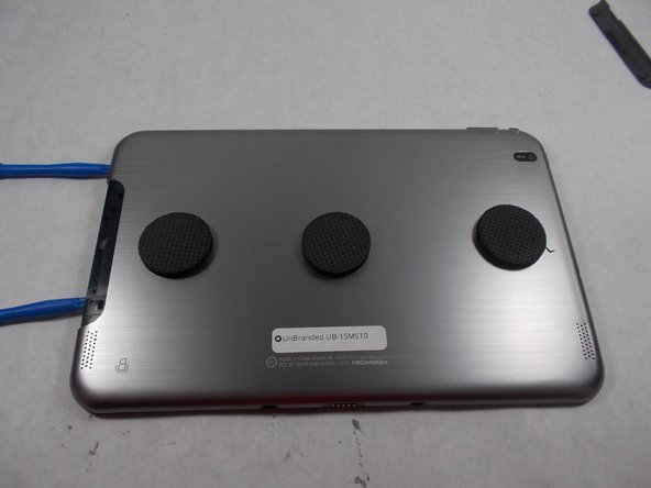

    • Insert opening tools to partially pry open the cover.
  4. Unbranded UB-15MS10 Screen Replacement: crwdns2935265:04crwdnd2935265:01crwdnd2935265:01crwdne2935265:0
    • With the cover being partially held open, slide a spudger around the seam to pry off the cover.
