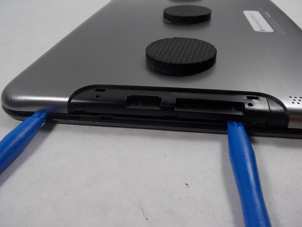

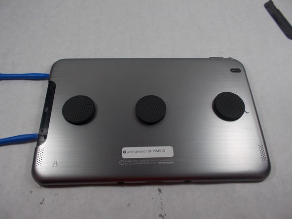

    • Use an opening tool to pry off the memory card door located on the back of the tablet.
  2. Unbranded UB-15MS10 Power Button Replacement: crwdns2935265:02crwdnd2935265:01crwdnd2935265:01crwdne2935265:0
    • Remove the two 1.2mm screws found under the memory card door.

    • Pry around the outside carefully using the black spudger to get in. Putting many opening tools around the edge helps keep it from sealing shut again.

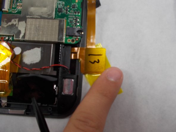

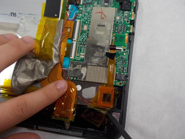

  5. Unbranded UB-15MS10 Power Button Replacement: crwdns2935265:05crwdnd2935265:01crwdnd2935265:03crwdne2935265:0 Unbranded UB-15MS10 Power Button Replacement: crwdns2935265:05crwdnd2935265:02crwdnd2935265:03crwdne2935265:0 Unbranded UB-15MS10 Power Button Replacement: crwdns2935265:05crwdnd2935265:03crwdnd2935265:03crwdne2935265:0
    • Peel up the grey tape so that you can get to the board and untape the ribbon cable that was removed from the motherboard in the previous step.

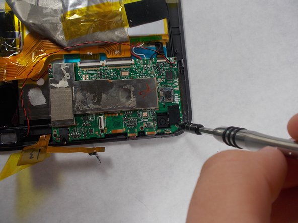

  6. Unbranded UB-15MS10 Power Button Replacement: crwdns2935265:06crwdnd2935265:01crwdnd2935265:02crwdne2935265:0 Unbranded UB-15MS10 Power Button Replacement: crwdns2935265:06crwdnd2935265:02crwdnd2935265:02crwdne2935265:0
    • Remove the two 1.2mm screws from the board.

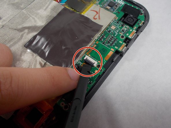

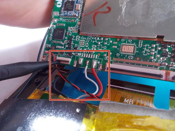

  8. Unbranded UB-15MS10 Power Button Replacement: crwdns2935265:08crwdnd2935265:01crwdnd2935265:02crwdne2935265:0 Unbranded UB-15MS10 Power Button Replacement: crwdns2935265:08crwdnd2935265:02crwdnd2935265:02crwdne2935265:0
    • Detach the three ribbon cables using spudger in the first picture. Then cut the black, white, and red wires shown in picture two.

  12. Unbranded UB-15MS10 Power Button Replacement: crwdns2935265:012crwdnd2935265:01crwdnd2935265:01crwdne2935265:0
    • Remove old motherboard from tablet. Take the new motherboard and splice the black wire of the board to the black wire of the battery. Do the same for the white and red wires.
