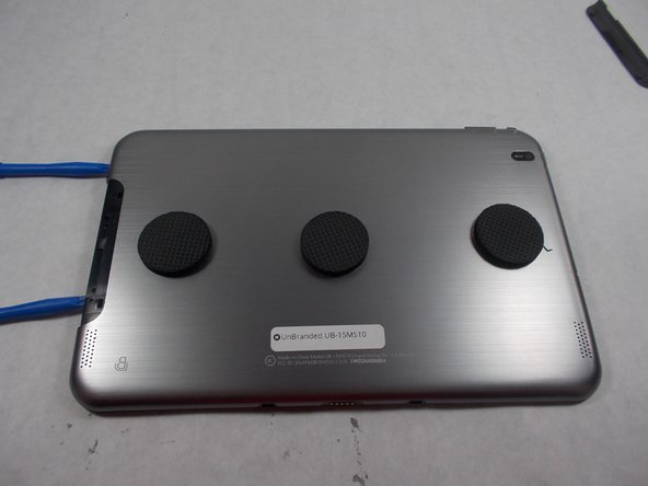

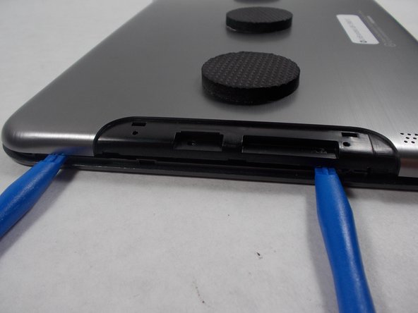

    • Use an opening tool to pry off the memory card door located on the back of the tablet.
  2. Unbranded UB-15MS10 Motherboard Replacement: crwdns2935265:02crwdnd2935265:01crwdnd2935265:01crwdne2935265:0
    • Remove the two 1.2mm screws found under the memory card door.
  3. Unbranded UB-15MS10 Motherboard Replacement: crwdns2935265:03crwdnd2935265:01crwdnd2935265:03crwdne2935265:0 Unbranded UB-15MS10 Motherboard Replacement: crwdns2935265:03crwdnd2935265:02crwdnd2935265:03crwdne2935265:0 Unbranded UB-15MS10 Motherboard Replacement: crwdns2935265:03crwdnd2935265:03crwdnd2935265:03crwdne2935265:0
    • Pry around the outside carefully using the black spudger to get in.
    • Putting many opening tools around the edge helps keep it from sealing shut again.

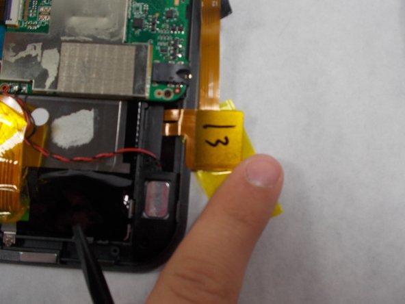

  4. Unbranded UB-15MS10 Motherboard Replacement: crwdns2935265:04crwdnd2935265:01crwdnd2935265:02crwdne2935265:0 Unbranded UB-15MS10 Motherboard Replacement: crwdns2935265:04crwdnd2935265:02crwdnd2935265:02crwdne2935265:0
    • Remove the ribbon cable by using the black spudger to release the tab and carefully pull out the ribbon cable.

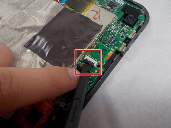

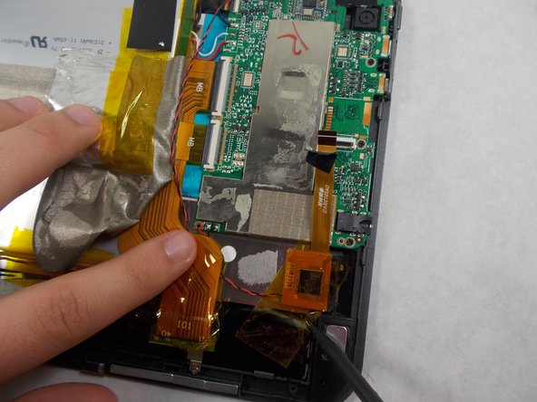

  5. Unbranded UB-15MS10 Motherboard Replacement: crwdns2935265:05crwdnd2935265:01crwdnd2935265:03crwdne2935265:0 Unbranded UB-15MS10 Motherboard Replacement: crwdns2935265:05crwdnd2935265:02crwdnd2935265:03crwdne2935265:0 Unbranded UB-15MS10 Motherboard Replacement: crwdns2935265:05crwdnd2935265:03crwdnd2935265:03crwdne2935265:0
    • Peel up the grey tape so that you can get to the board and untape the ribbon cable that was removed from the motherboard in the previous step.

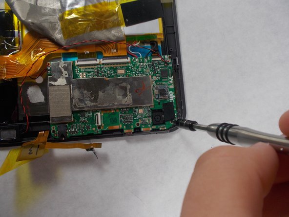

  6. Unbranded UB-15MS10 Motherboard Replacement: crwdns2935265:06crwdnd2935265:01crwdnd2935265:02crwdne2935265:0 Unbranded UB-15MS10 Motherboard Replacement: crwdns2935265:06crwdnd2935265:02crwdnd2935265:02crwdne2935265:0
    • Remove the five 1.2mm screws from the board.
  7. Unbranded UB-15MS10 Motherboard Replacement: crwdns2935265:07crwdnd2935265:01crwdnd2935265:01crwdne2935265:0
    • Use an opening tool to remove the board from the case.

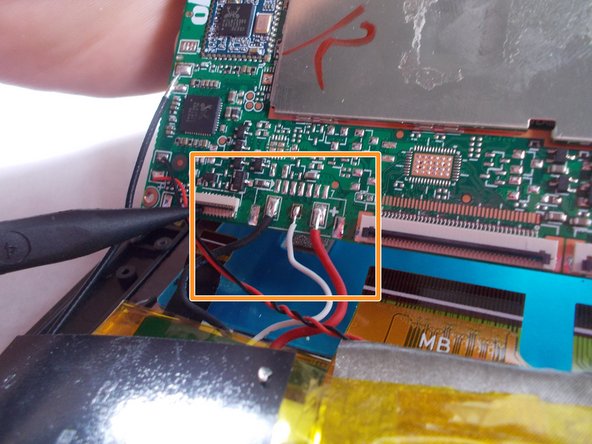

  8. Unbranded UB-15MS10 Motherboard Replacement: crwdns2935265:08crwdnd2935265:01crwdnd2935265:02crwdne2935265:0 Unbranded UB-15MS10 Motherboard Replacement: crwdns2935265:08crwdnd2935265:02crwdnd2935265:02crwdne2935265:0
    • Detach the three ribbon cables using a spudger
    • Desolder the black, white, and red wires.

  11. Unbranded UB-15MS10 Motherboard Replacement: crwdns2935265:011crwdnd2935265:01crwdnd2935265:01crwdne2935265:0
    • Remove the old motherboard from the tablet.
    • Take the new motherboard and solder the black wire of the board to the black wire of the battery.
    • Do the same for the white and red wires.
