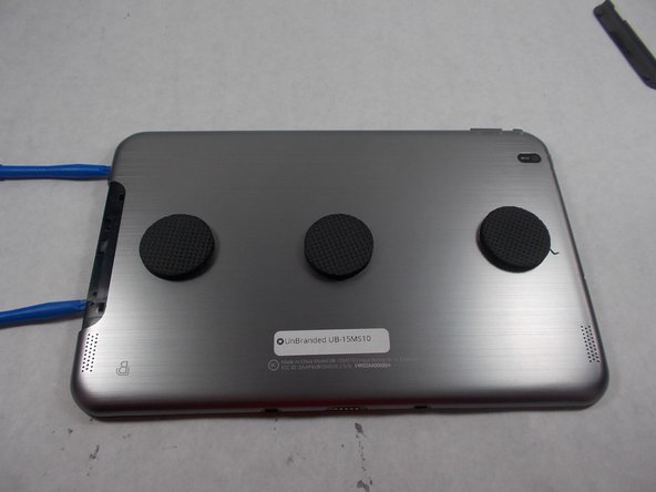

    • Use an opening tool to pry off the lid of the memory card compartment.
  2. Unbranded UB-15MS10 Battery Replacement: crwdns2935265:02crwdnd2935265:01crwdnd2935265:01crwdne2935265:0
    • Remove the two 1.2 mm screws within the compartment using a Phillips #00 screwdriver.
  3. Unbranded UB-15MS10 Battery Replacement: crwdns2935265:03crwdnd2935265:01crwdnd2935265:02crwdne2935265:0 Unbranded UB-15MS10 Battery Replacement: crwdns2935265:03crwdnd2935265:02crwdnd2935265:02crwdne2935265:0
    • Insert opening tools to partially pry open the cover.
  4. Unbranded UB-15MS10 Battery Replacement: crwdns2935265:04crwdnd2935265:01crwdnd2935265:01crwdne2935265:0
    • With the cover being partially held open, slide a spudger around the seam to pry off the cover.
  5. Unbranded UB-15MS10 Battery Replacement: crwdns2935265:05crwdnd2935265:01crwdnd2935265:01crwdne2935265:0
    • Remove the tape that is holding the battery in place.
  6. Unbranded UB-15MS10 Battery Replacement: crwdns2935265:06crwdnd2935265:01crwdnd2935265:01crwdne2935265:0
    • Cut the wires connecting the battery to the device using a pair of wire cutters.
  7. Unbranded UB-15MS10 Battery Replacement: crwdns2935265:07crwdnd2935265:01crwdnd2935265:01crwdne2935265:0
    • Carefully remove the battery, making sure that all wires are disconnected.
  8. Unbranded UB-15MS10 Battery Replacement: crwdns2935265:08crwdnd2935265:01crwdnd2935265:01crwdne2935265:0
    • Splice the new battery with the red, white, and black wires connected to the motherboard.
To reassemble your device, follow directions 1-7 in reverse order.
