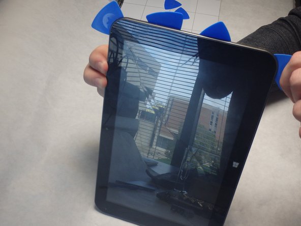

    3. Unbranded UB-15MS10 Back Camera Replacement: crwdns2935265:03crwdnd2935265:01crwdnd2935265:02crwdne2935265:0 Unbranded UB-15MS10 Back Camera Replacement: crwdns2935265:03crwdnd2935265:02crwdnd2935265:02crwdne2935265:0
      • Insert blue guitar picks in the crease between the top and bottom panels starting on the same end as the Micro SD slot.
      • Inserting the picks directly under the Micro SD compartment was the easiest place to get started. It still requires some force.
    4. Unbranded UB-15MS10 Back Camera Replacement: crwdns2935265:04crwdnd2935265:01crwdnd2935265:01crwdne2935265:0
      • Insert the black spudger between the guitar picks in order to pry open gaps between the blue guitar picks.
      • As the gaps open, slide the guitar picks along the sides to separate the panels.
    5. Unbranded UB-15MS10 Back Camera Replacement: crwdns2935265:05crwdnd2935265:01crwdnd2935265:01crwdne2935265:0
      • Pry all four sides apart using the blue guitar picks and the black spudger until they can easily be pried apart by hand.
