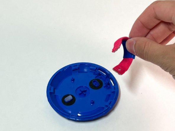

    • Take the mesh covering off of the speaker by pressing on the center of the speaker and pulling the mesh upwards.
  4. Ultimate Ears Wonderboom 3 Holding Strap Replacement, Holding Strap: crwdns2935265:04crwdnd2935265:01crwdnd2935265:02crwdne2935265:0 Ultimate Ears Wonderboom 3 Holding Strap Replacement, Holding Strap: crwdns2935265:04crwdnd2935265:02crwdnd2935265:02crwdne2935265:0
    • Grabbing the top of the speaker that was removed earlier, remove both of the strap endings that are stuck through as seen above.
    • Feed the strap through the hole and pull it out.
