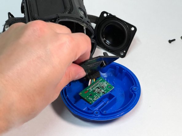

  7. Ultimate Ears Wonderboom 3 Charging Port Replacement: crwdns2935265:07crwdnd2935265:01crwdnd2935265:01crwdne2935265:0
    • Using the soldering iron, desolder the white and black wires (the 2 connections) at the top of the speaker driver.
  8. Ultimate Ears Wonderboom 3 Charging Port Replacement, Battery: crwdns2935265:08crwdnd2935265:01crwdnd2935265:02crwdne2935265:0 Ultimate Ears Wonderboom 3 Charging Port Replacement, Battery: crwdns2935265:08crwdnd2935265:02crwdnd2935265:02crwdne2935265:0
    • Locate and unscrew the M3 x 8mm screws found under each of the four speakers.
  9. Ultimate Ears Wonderboom 3 Charging Port Replacement: crwdns2935265:09crwdnd2935265:01crwdnd2935265:03crwdne2935265:0 Ultimate Ears Wonderboom 3 Charging Port Replacement: crwdns2935265:09crwdnd2935265:02crwdnd2935265:03crwdne2935265:0 Ultimate Ears Wonderboom 3 Charging Port Replacement: crwdns2935265:09crwdnd2935265:03crwdnd2935265:03crwdne2935265:0
    • Remove the main center of the speaker, exposing the bottom and the battery.
    • Carefully place the metal spudger under the battery. Being slow yet forceful, push the spudger under the battery and force upwards. This will pry the waterproof adhesive, affecting its ability to be waterproof in the future.
    • Be careful not to puncture the battery when doing this step.
    • Remove the battery from the adhesive and set it aside.
  10. Ultimate Ears Wonderboom 3 Charging Port Replacement: crwdns2935265:010crwdnd2935265:01crwdnd2935265:01crwdne2935265:0
    • Using the iFixit Large Needle Nose Pliers, remove the red wire connecter that is attached to the battery.
    • Sometimes there is a little bit of glue on the connecter that can make it difficult to remove.
    • Pull the battery out of the device
  11. Ultimate Ears Wonderboom 3 Charging Port Replacement, Charging Port: crwdns2935265:011crwdnd2935265:01crwdnd2935265:02crwdne2935265:0 Ultimate Ears Wonderboom 3 Charging Port Replacement, Charging Port: crwdns2935265:011crwdnd2935265:02crwdnd2935265:02crwdne2935265:0
    • Using the iFixit screwdriver, unscrew the three M2 x 5mm screws on the battery base plate.
    • Once all three M2 x 5mm screws are removed, take the battery plate completely off of the device and set it to the side.
  12. Ultimate Ears Wonderboom 3 Charging Port Replacement: crwdns2935265:012crwdnd2935265:01crwdnd2935265:01crwdne2935265:0
    • Remove the charging port and replace it with a new one
