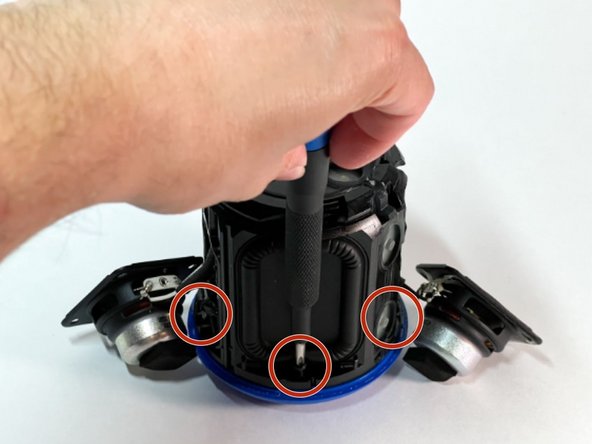

  8. Ultimate Ears Wonderboom 3 Battery Replacement, Battery: crwdns2935265:08crwdnd2935265:01crwdnd2935265:02crwdne2935265:0 Ultimate Ears Wonderboom 3 Battery Replacement, Battery: crwdns2935265:08crwdnd2935265:02crwdnd2935265:02crwdne2935265:0
    • Locate and unscrew the M3 x 8mm screws found under each of the four speakers.

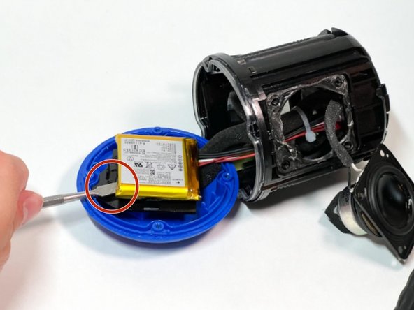

    • Remove the main center of the speaker, exposing the bottom and the battery.
    • Carefully place the metal spudger under the battery. Being slow yet forceful, push the spudger under the battery and force upwards. This will pry the waterproof adhesive, affecting its ability to be waterproof in the future.
    • Be careful not to puncture the battery when doing this step.
    • Remove the battery from the adhesive and set it aside.

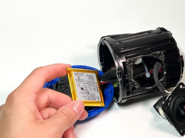

  10. Ultimate Ears Wonderboom 3 Battery Replacement: crwdns2935265:010crwdnd2935265:01crwdnd2935265:01crwdne2935265:0
    • Using the iFixit Large Needle Nose Pliers, remove the red wire connecter that is attached to the battery.
    • Sometimes there is a little bit of glue on the connecter that can make it difficult to remove.
    • Pull the battery out of the device
