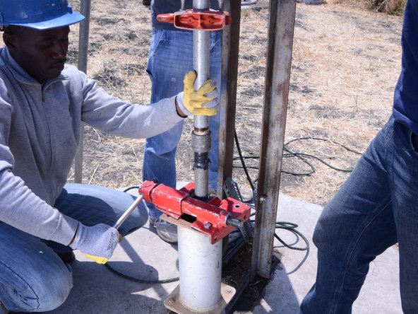

  7. Ukujamisela ipompo yehlathi yevelifu yenyawo, Riser Main Slider (Ndembele): crwdns2935265:07crwdnd2935265:01crwdnd2935265:02crwdne2935265:0 Ukujamisela ipompo yehlathi yevelifu yenyawo, Riser Main Slider (Ndembele): crwdns2935265:07crwdnd2935265:02crwdnd2935265:02crwdne2935265:0
    • Ngokuqina phakamisa isikhuphukeli sephayiphu edlulisa amanzi, ngezandla zombili.
    • Thlogomela ukobana ungawisi isikhuphukeli sephayiphu edlulisa amanzi ngombana lokho kungona ipompo nesilinda.
  8. Ukujamisela ipompo yehlathi yevelifu yenyawo: crwdns2935265:08crwdnd2935265:01crwdnd2935265:03crwdne2935265:0 Ukujamisela ipompo yehlathi yevelifu yenyawo: crwdns2935265:08crwdnd2935265:02crwdnd2935265:03crwdne2935265:0 Ukujamisela ipompo yehlathi yevelifu yenyawo: crwdns2935265:08crwdnd2935265:03crwdnd2935265:03crwdne2935265:0
    • Sebenzisa isipanere sephayiphu ukulenza ligedle ubungaphezulu bephayiphu esikhuphukeleni.
  9. Ukujamisela ipompo yehlathi yevelifu yenyawo: crwdns2935265:09crwdnd2935265:01crwdnd2935265:03crwdne2935265:0 Ukujamisela ipompo yehlathi yevelifu yenyawo: crwdns2935265:09crwdnd2935265:02crwdnd2935265:03crwdne2935265:0 Ukujamisela ipompo yehlathi yevelifu yenyawo: crwdns2935265:09crwdnd2935265:03crwdnd2935265:03crwdne2935265:0
    • Phakamisa isitjheleli nesikhuphukeli nephayiphu edlulisa amanzi.
    • Beka ipompo nentonga bese uyayiqinisa kuzungeza intonga, uyibophe uyiqinise hlangana nepompo nentonga.
    • Ngokutjheja yehlisa isikhuphukeli nephayiphu edlulisa amanzi nesitjheleli ukuvumela bona izithekghe phezu kwentonga kuqina.

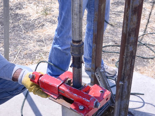

  10. Ukujamisela ipompo yehlathi yevelifu yenyawo: crwdns2935265:010crwdnd2935265:01crwdnd2935265:03crwdne2935265:0 Ukujamisela ipompo yehlathi yevelifu yenyawo: crwdns2935265:010crwdnd2935265:02crwdnd2935265:03crwdne2935265:0 Ukujamisela ipompo yehlathi yevelifu yenyawo: crwdns2935265:010crwdnd2935265:03crwdnd2935265:03crwdne2935265:0
    • Gedlisa bese ususa zombili ipompo nentonga bese uminyezele endaweni encani ngokungasikinyeki imbumbulu phezu kwesitjheleli.
  11. Ukujamisela ipompo yehlathi yevelifu yenyawo: crwdns2935265:011crwdnd2935265:01crwdnd2935265:02crwdne2935265:0 Ukujamisela ipompo yehlathi yevelifu yenyawo: crwdns2935265:011crwdnd2935265:02crwdnd2935265:02crwdne2935265:0
    • Susa ingaphezulu lesikhuphukeli sephayiphu edlulisa amanzi, bese uyihlola bona ayikasinyeki nanyana ayikarathuki.

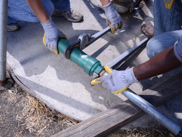

  13. Ukujamisela ipompo yehlathi yevelifu yenyawo, Spout (Ndembele): crwdns2935265:013crwdnd2935265:01crwdnd2935265:03crwdne2935265:0 Ukujamisela ipompo yehlathi yevelifu yenyawo, Spout (Ndembele): crwdns2935265:013crwdnd2935265:02crwdnd2935265:03crwdne2935265:0 Ukujamisela ipompo yehlathi yevelifu yenyawo, Spout (Ndembele): crwdns2935265:013crwdnd2935265:03crwdnd2935265:03crwdne2935265:0
    • Sebenzisa isikrufu sephayiphu ukugedlisa nokususa itjhubhu yepompo
    • Hlola itjhubhu bona ayithikamezeki nanyana isilaphazeke.
    • Beka itjhubhu endaweni ehlwengekileko ukuvimbela ukusilaphazeka.

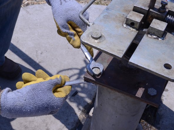

  14. Ukujamisela ipompo yehlathi yevelifu yenyawo, Riser Main (Ndembele): crwdns2935265:014crwdnd2935265:01crwdnd2935265:03crwdne2935265:0 Ukujamisela ipompo yehlathi yevelifu yenyawo, Riser Main (Ndembele): crwdns2935265:014crwdnd2935265:02crwdnd2935265:03crwdne2935265:0 Ukujamisela ipompo yehlathi yevelifu yenyawo, Riser Main (Ndembele): crwdns2935265:014crwdnd2935265:03crwdnd2935265:03crwdne2935265:0
    • Beka isikrufu sinye phezu kwepompo yesikhuphukeli sesitja samabowhudu.
    • Beka esinye isikrufu kuzungeza ngaphasi kwebhowudu.
    • Dosa iinkrufu uzihlukanise bona zigedlise amabhowudu.
    • Buyelela isenzekwesi emabhowudwini amathathu aseleko.

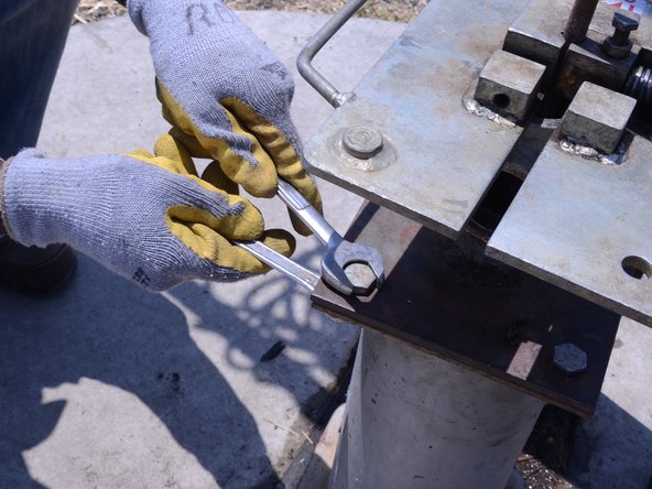

  15. Ukujamisela ipompo yehlathi yevelifu yenyawo: crwdns2935265:015crwdnd2935265:01crwdnd2935265:02crwdne2935265:0 Ukujamisela ipompo yehlathi yevelifu yenyawo: crwdns2935265:015crwdnd2935265:02crwdnd2935265:02crwdne2935265:0
    • Susa iimbumbulu ezine namabhowudu avikele isikhuphukeli sepompo sesitja uzibeke esiphathweni esibona ilanga esinjenge bakhede.
  16. Ukujamisela ipompo yehlathi yevelifu yenyawo: crwdns2935265:016crwdnd2935265:01crwdnd2935265:02crwdne2935265:0 Ukujamisela ipompo yehlathi yevelifu yenyawo: crwdns2935265:016crwdnd2935265:02crwdnd2935265:02crwdne2935265:0

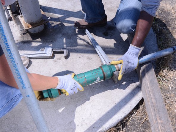

  36. Ukujamisela ipompo yehlathi yevelifu yenyawo, Cylinder (Ndembele): crwdns2935265:036crwdnd2935265:01crwdnd2935265:01crwdne2935265:0
    • Tjheja bona ubeka isilinda kude nehlabathi ukobana ingasinyeki nanyana isilaphazeke.
  37. Ukujamisela ipompo yehlathi yevelifu yenyawo: crwdns2935265:037crwdnd2935265:01crwdnd2935265:03crwdne2935265:0 Ukujamisela ipompo yehlathi yevelifu yenyawo: crwdns2935265:037crwdnd2935265:02crwdnd2935265:03crwdne2935265:0 Ukujamisela ipompo yehlathi yevelifu yenyawo: crwdns2935265:037crwdnd2935265:03crwdnd2935265:03crwdne2935265:0
    • Usebenzisa amabhowudu wamaphayiphu amabili, skrufulula isilinda esikhuphukeni sephayiphu edlulisa amanzi.
  38. Ukujamisela ipompo yehlathi yevelifu yenyawo: crwdns2935265:038crwdnd2935265:01crwdnd2935265:02crwdne2935265:0 Ukujamisela ipompo yehlathi yevelifu yenyawo: crwdns2935265:038crwdnd2935265:02crwdnd2935265:02crwdne2935265:0
    • Buthaka dosa isilinda esuka epompeni yentonga bese ulisa ivelifu ekhambako nevelifu yenyawo.
