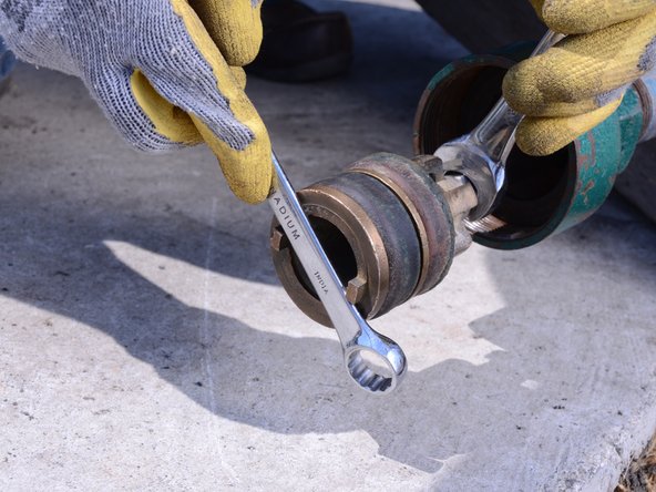

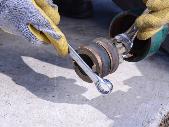

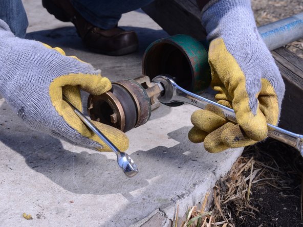

  39. Ukujamisela Ipompo Yehlathi Ngevelifu Ekhamabako, Traveling Valve (Ndembele): crwdns2935265:039crwdnd2935265:01crwdnd2935265:03crwdne2935265:0 Ukujamisela Ipompo Yehlathi Ngevelifu Ekhamabako, Traveling Valve (Ndembele): crwdns2935265:039crwdnd2935265:02crwdnd2935265:03crwdne2935265:0 Ukujamisela Ipompo Yehlathi Ngevelifu Ekhamabako, Traveling Valve (Ndembele): crwdns2935265:039crwdnd2935265:03crwdnd2935265:03crwdne2935265:0
    • Faka isikrufu ennkhaleni ezingaphasi kwamavelifu akhambako.
    • Usebenzisa esinye isikrufu ngokusebenzisa ileva, skrufulula ivelifu ukusukela entongeni.

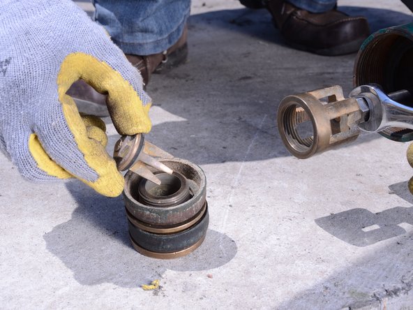

  40. Ukujamisela Ipompo Yehlathi Ngevelifu Ekhamabako: crwdns2935265:040crwdnd2935265:01crwdnd2935265:02crwdne2935265:0 Ukujamisela Ipompo Yehlathi Ngevelifu Ekhamabako: crwdns2935265:040crwdnd2935265:02crwdnd2935265:02crwdne2935265:0
    • Skrufulula ivelifu ukusuka entongeni yepompo.
  41. Ukujamisela Ipompo Yehlathi Ngevelifu Ekhamabako: crwdns2935265:041crwdnd2935265:01crwdnd2935265:03crwdne2935265:0 Ukujamisela Ipompo Yehlathi Ngevelifu Ekhamabako: crwdns2935265:041crwdnd2935265:02crwdnd2935265:03crwdne2935265:0 Ukujamisela Ipompo Yehlathi Ngevelifu Ekhamabako: crwdns2935265:041crwdnd2935265:03crwdnd2935265:03crwdne2935265:0
    • Tjheja ukubeka insebenziswa zamavelifu kude nehlabathi.
    • Qala insebenziswa zevelifu bona azikasinyeki nanyana ukurathuka.
  42. Ukujamisela Ipompo Yehlathi Ngevelifu Ekhamabako: crwdns2935265:042crwdnd2935265:01crwdnd2935265:02crwdne2935265:0 Ukujamisela Ipompo Yehlathi Ngevelifu Ekhamabako: crwdns2935265:042crwdnd2935265:02crwdnd2935265:02crwdne2935265:0
    • Susa iphophethi evelufini ukuqala bona ayinampawu zokusinyeka.
    • Yenza mbala bona indlela insebenziswa zakho zingahlangana. Lokho kubalulekile, ngombana ipompo ayizosebenza na ivelifu ingakafakwa kuhle.
