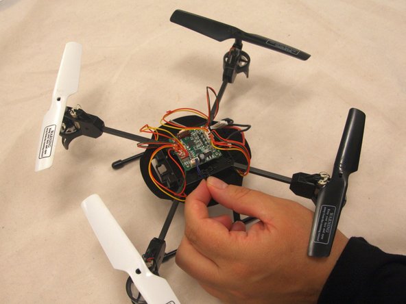

    • Place the drone on its back, with the runners facing upward.
    • Using the Phillips #00 screwdriver, unscrew the single 2mm screw located on the drone body which connects the headlamp and wiring to the center of the drone frame.
  2. Udi Discovery U818A FPV Camera Replacement: crwdns2935265:02crwdnd2935265:01crwdnd2935265:01crwdne2935265:0
    • Grasp one of the propeller arms with the fingers of one hand while holding the drone frame with the other hand.
    • Firmly pull the propeller arm upward to separate it from the drone body.
    • Repeat this process to remove the three other propeller arms.
  3. Udi Discovery U818A FPV Camera Replacement: crwdns2935265:03crwdnd2935265:01crwdnd2935265:01crwdne2935265:0
    • Carefully remove the drone body from the frame.
  4. Udi Discovery U818A FPV Camera Replacement: crwdns2935265:04crwdnd2935265:01crwdnd2935265:02crwdne2935265:0 Udi Discovery U818A FPV Camera Replacement: crwdns2935265:04crwdnd2935265:02crwdnd2935265:02crwdne2935265:0
    • Flip the drone body onto the runners so the wires and motherboard are facing upward.
    • Disconnect the black and blue camera wires from the motherboard.
    • You may need to use a pointed metal pick to loosen the red putty that holds the connectors together.
  5. Udi Discovery U818A FPV Camera Replacement: crwdns2935265:05crwdnd2935265:01crwdnd2935265:01crwdne2935265:0
    • Be careful when separating the camera away from the runners and drone body—the plastic is brittle and may snap, causing injury to the hand.
    • Pry the camera away from the main drone body.
    • Use a spudger for extra leverage if the parts do not easily separate.
