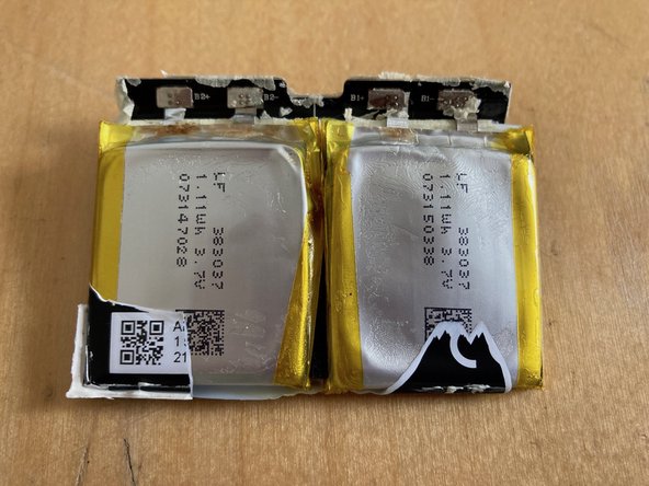

    • Because of the original batterys special form factor it was impossible to find sth that fits. I found a Lithium battery from a model aircraft shop with 7.4 V and 280 mA
  2. Ubiquiti Cloud Key Gen2: How to replace faulty battery: crwdns2935265:02crwdnd2935265:01crwdnd2935265:01crwdne2935265:0
    • Because this battery is larger than the original one I decided to mount it in the HD cage. I replaced original HD with a Samsung SSD. Take out the SSD of its housing for having more space. As you can see I mount a cable from the place of the original battery to the new place in the HD cage. The SSD will be auto formated by the system !
  3. Ubiquiti Cloud Key Gen2: How to replace faulty battery: crwdns2935265:03crwdnd2935265:01crwdnd2935265:01crwdne2935265:0
    • Soldering the original battery connector to the cable. Battery has 3 lines
  4. Ubiquiti Cloud Key Gen2: How to replace faulty battery: crwdns2935265:04crwdnd2935265:01crwdnd2935265:01crwdne2935265:0
    • Replacement battery fixed with cable ties. I wrote down the colour assignment of my cables and put it in the HD cage.
  5. Ubiquiti Cloud Key Gen2: How to replace faulty battery: crwdns2935265:05crwdnd2935265:01crwdnd2935265:01crwdne2935265:0
    • ...the old battery
  6. Ubiquiti Cloud Key Gen2: How to replace faulty battery: crwdns2935265:06crwdnd2935265:01crwdnd2935265:01crwdne2935265:0
    • mission accomplished :-)
  7. Ubiquiti Cloud Key Gen2: How to replace faulty battery: crwdns2935265:07crwdnd2935265:01crwdnd2935265:02crwdne2935265:0 Ubiquiti Cloud Key Gen2: How to replace faulty battery: crwdns2935265:07crwdnd2935265:02crwdnd2935265:02crwdne2935265:0
    • After some weeks of not using the device the shutdown function did not work. After checking some UI forums I found out there is a circuit board inside the dead battery.
    • I also found 2 LiPo cells with the suitable Watts and Voltages. Unfortunately my charging board is faulty. So I did further test with ordinary alkaline batteries.
  8. Ubiquiti Cloud Key Gen2: How to replace faulty battery: crwdns2935265:08crwdnd2935265:01crwdnd2935265:01crwdne2935265:0
    • I testet 6x AAA batterys. This scenario also works, but there will not be enough space in the HD caddy. Finally a 9 V battery block did the job.
    • As I found out the newest generation of Cloud Keys is produced with no battery. I just had 2 new CKs, both switched off immediately when loosing PoE power. It seems with new Unifi OS the device can deal better with powerloss.
    • Nevertheless I suggest changing the 2.5" HD with a 2.5" SSD and doing safe backups of your config. USV powering of PoE switch is recommendable.
