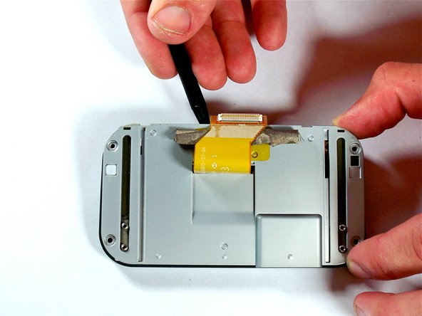

  19. UTStarcom XV6700 Screen Replacement: crwdns2935265:019crwdnd2935265:01crwdnd2935265:02crwdne2935265:0 UTStarcom XV6700 Screen Replacement: crwdns2935265:019crwdnd2935265:02crwdnd2935265:02crwdne2935265:0
    • Carefully pull the display cable through the opening in the keyboard panel. The keyboard panel can then be set aside.

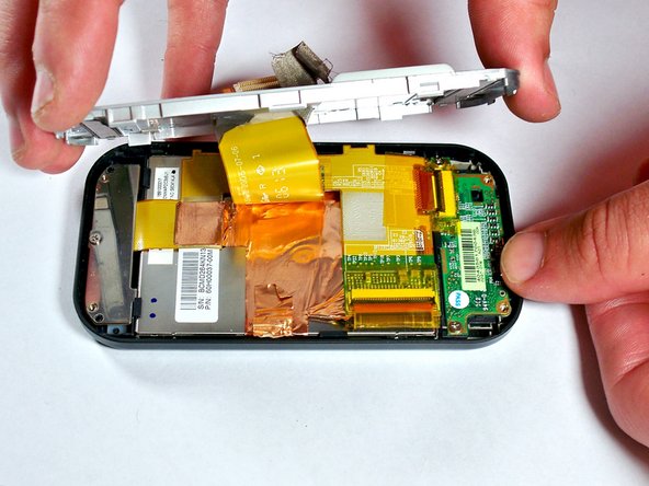

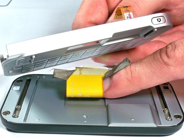

  21. UTStarcom XV6700 Screen Replacement: crwdns2935265:021crwdnd2935265:01crwdnd2935265:03crwdne2935265:0 UTStarcom XV6700 Screen Replacement: crwdns2935265:021crwdnd2935265:02crwdnd2935265:03crwdne2935265:0 UTStarcom XV6700 Screen Replacement: crwdns2935265:021crwdnd2935265:03crwdnd2935265:03crwdne2935265:0
    • Pry the silver cover off the screen enclosure. The display cable should be pulled through the opening in the silver cover.

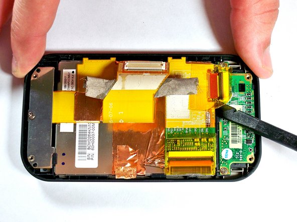

  22. UTStarcom XV6700 Screen Replacement: crwdns2935265:022crwdnd2935265:01crwdnd2935265:02crwdne2935265:0 UTStarcom XV6700 Screen Replacement: crwdns2935265:022crwdnd2935265:02crwdnd2935265:02crwdne2935265:0
    • Use the spudger to remove the tape from the connector between the screen and the front button circuit board.
    • Pry up on the brown connector to remove.

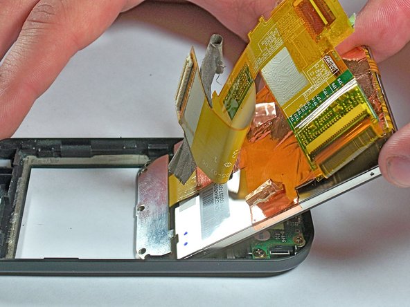

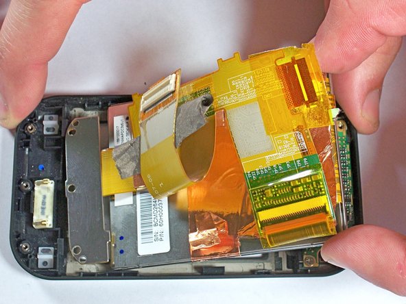

  24. UTStarcom XV6700 Screen Replacement: crwdns2935265:024crwdnd2935265:01crwdnd2935265:03crwdne2935265:0 UTStarcom XV6700 Screen Replacement: crwdns2935265:024crwdnd2935265:02crwdnd2935265:03crwdne2935265:0 UTStarcom XV6700 Screen Replacement: crwdns2935265:024crwdnd2935265:03crwdnd2935265:03crwdne2935265:0
    • Remove the screen by using the spudger to gently but firmly pry the screen away from the outer case.
    • Use your hand to lift the screen completely away from the case.
